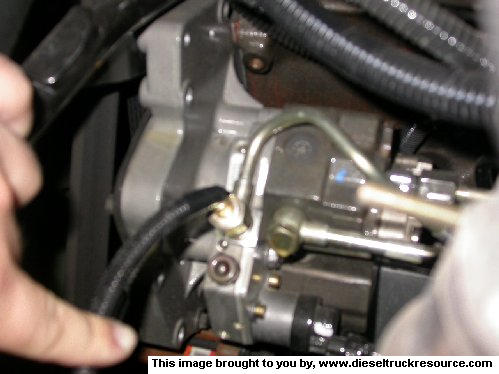

Old Aug 17, 2005 | 07:54 AM
MedicShawn's Avatar
Posts: 552
From: Virginia
Here's where I tapped in with my banjo boltfrom Genos
