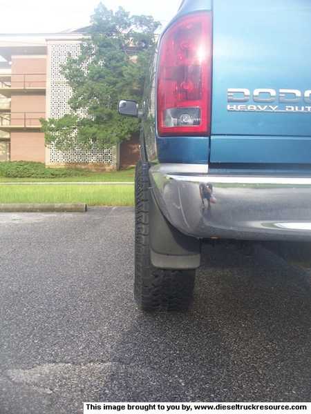

I have 35/12.50/17 Interco Vortracs on H2 wheels with stock suspension and they stick out probably 3/4-1" and only rub when backing up and turning. Even then its just barely on the mud flap. Im going to get a leveling kit as soon as I decide which one. They look good and ride real quiet.

Mine are only hitting the mudflap also. They just barely rub and only if backing up or turning forward sharp too fast.
heres how they stick out in the back:
