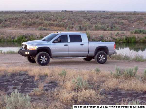

Phil.... Nice truck!!!!!

Not 20's but 17's!!! 2" leveling kit!!
