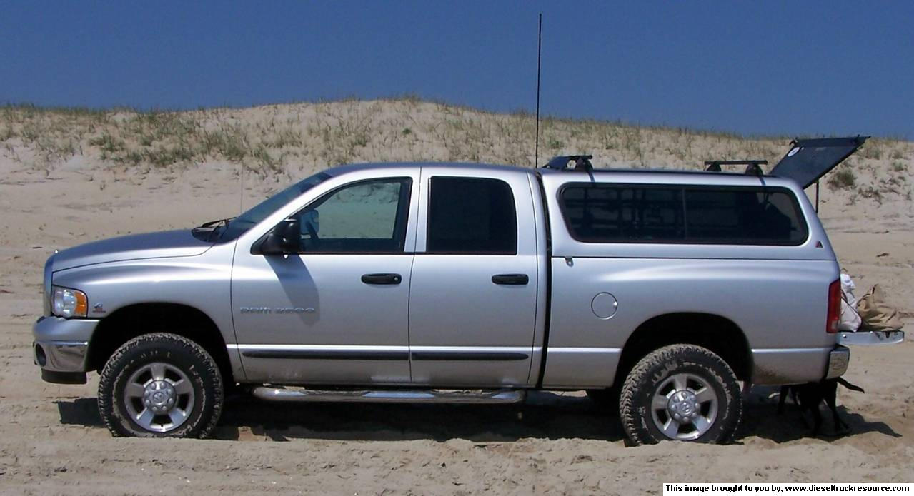

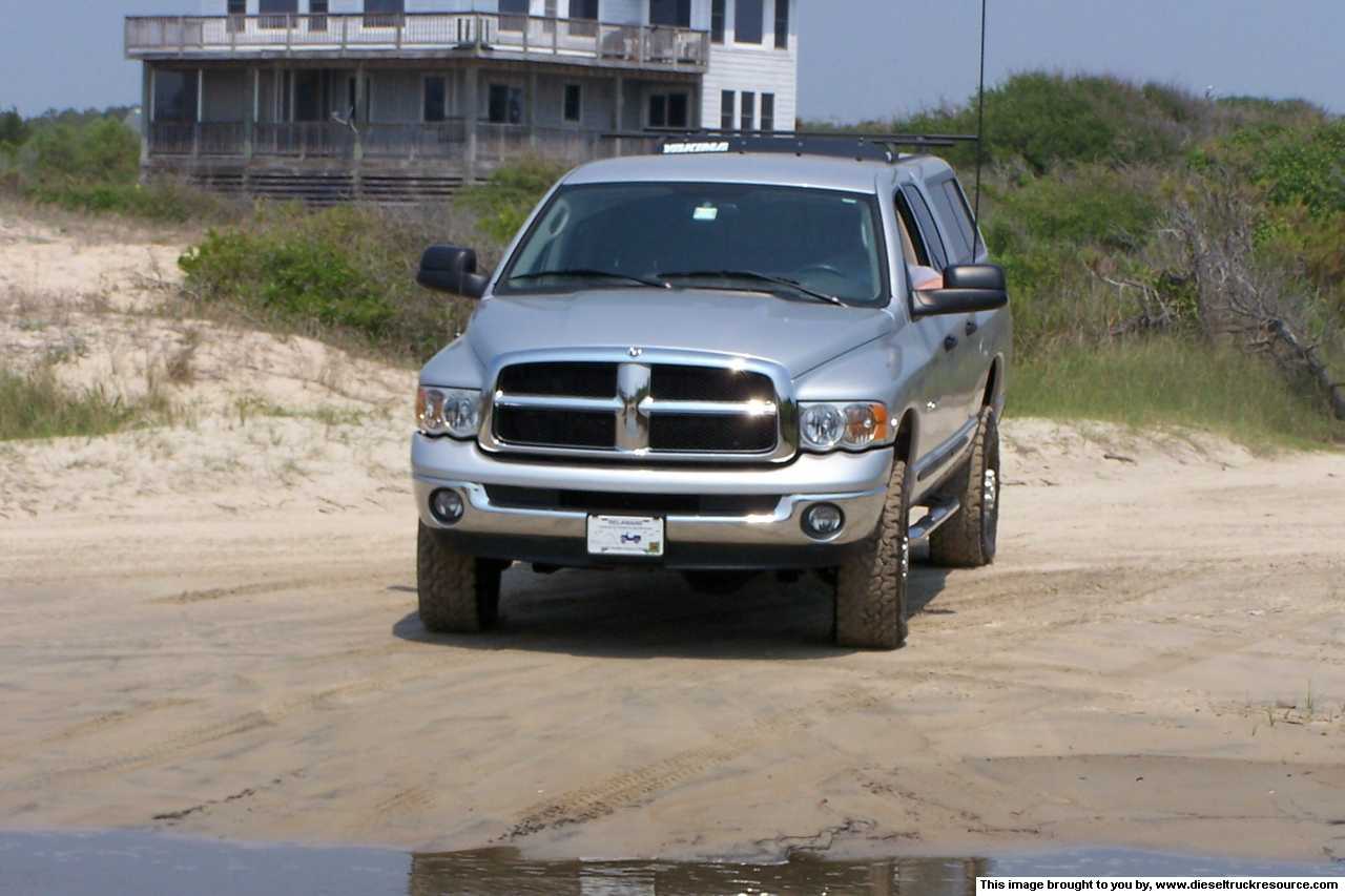

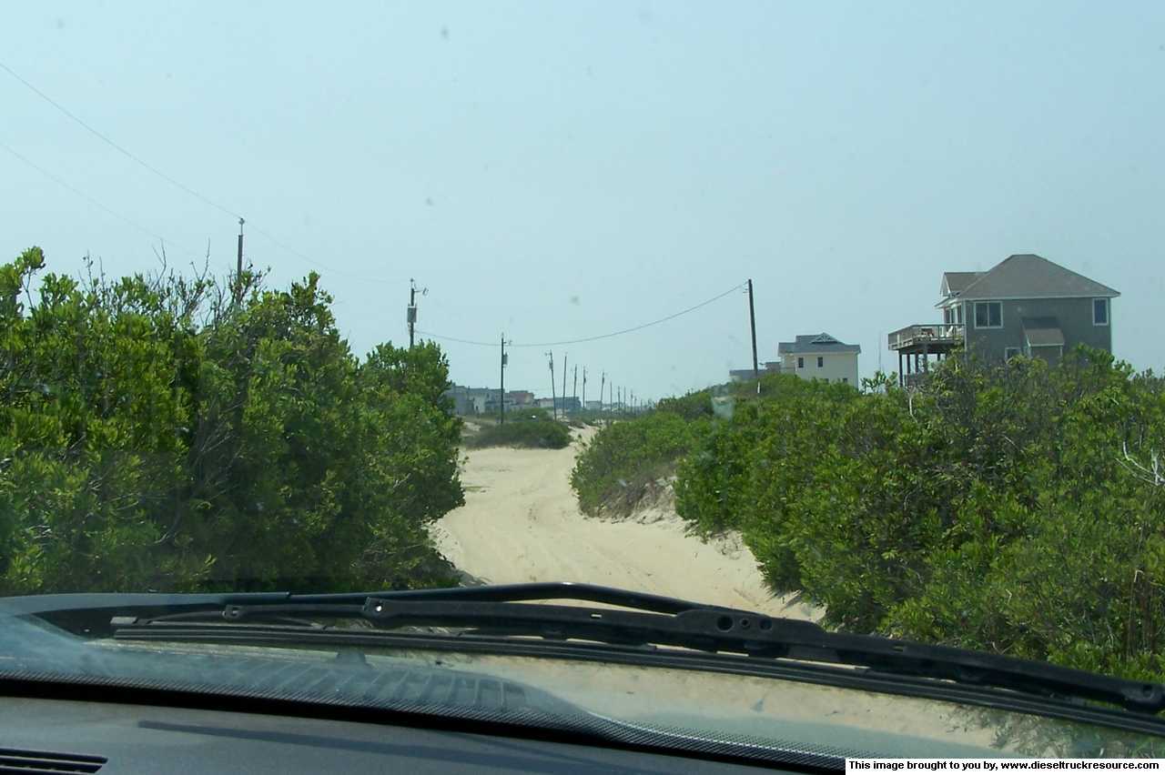

Old Apr 15, 2007 | 01:38 PM
surfram's Avatar
Posts: 1,125
From: Delaware
BFG AT KOs have always worked great for me on the sand. 10+ years of beach running on the Delaware beaches and the Outer Banks with no stucks.
