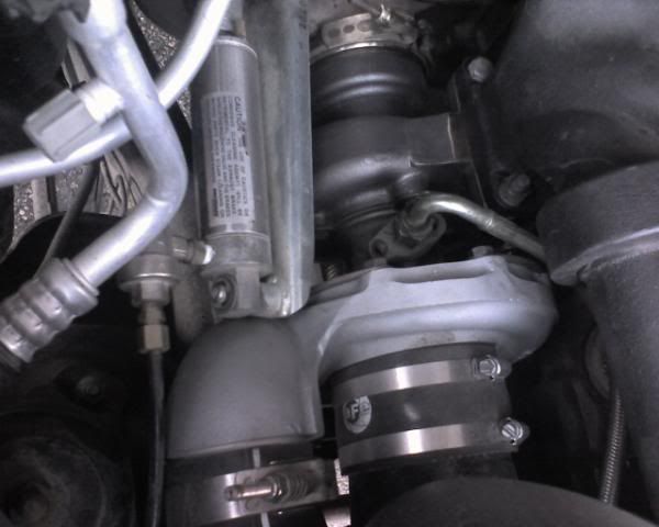

I have had both an HTB2 and currently a HTT 62/71/13ss on my truck with a Pac each time. I had to grind the end off of the cylinder mount a bit in both applications but it does fit and function properly. I inlcuded a pic but it's hard to tell. I had to grind the end closest to the compressor housing. The grind goes to the weld on the mount. I can't vouch for any other turbos than these two.

i had a II sps62/14 with my prxb. just had to grind a tad off the cylinder mount like starma. maybe 1/4"
