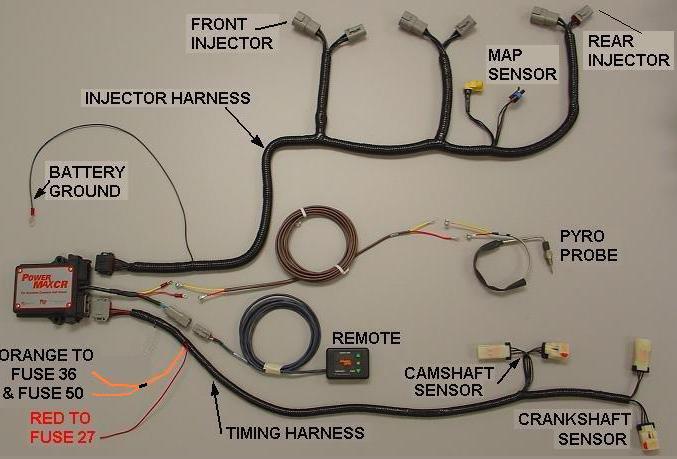

Hey guys, can anyone tell me what fues to tap for a tst r49. I checked on there site for the instructions, but my computer wont open them. I left my instructions in my pickup on the other side of the state. Were installing my tst on my brothers pickup to go dyno in about 3 hours. Could anyone help me by checking what fueses to tap into? Thanks a bunch guys Joel.

On my 03 I have the red wire tap on fuse #27 a red 10 amp.
Orange wire I have on #36 also a red 10 amp.

I just looked at TST's website and they show two orange wires that are to be connected to two different fuses. My R49 is older, and only has one that I know of. If yours has two orange wires, one wire goes to #36 and the other to #50. It does not say if it matters which orange wire goes to which fuse, so it should not matter. You can always reverse them if something doesn't work correctly.
Here is a photo that may help out

Come to think of it you did not say what year the truck was. The instructions I posted are for 03-05. It is slightly different for 06. Let me know.

Its for an 03, thanks for the help guys, I called wap and he checked under the hood for me. Adam thats exactly what wap told me but ive got and r49 so there are two ornge wire. Everything work so hopefully it will dyno something decent. Thanks again for all the help. Ill report back on the numbers. Joel
