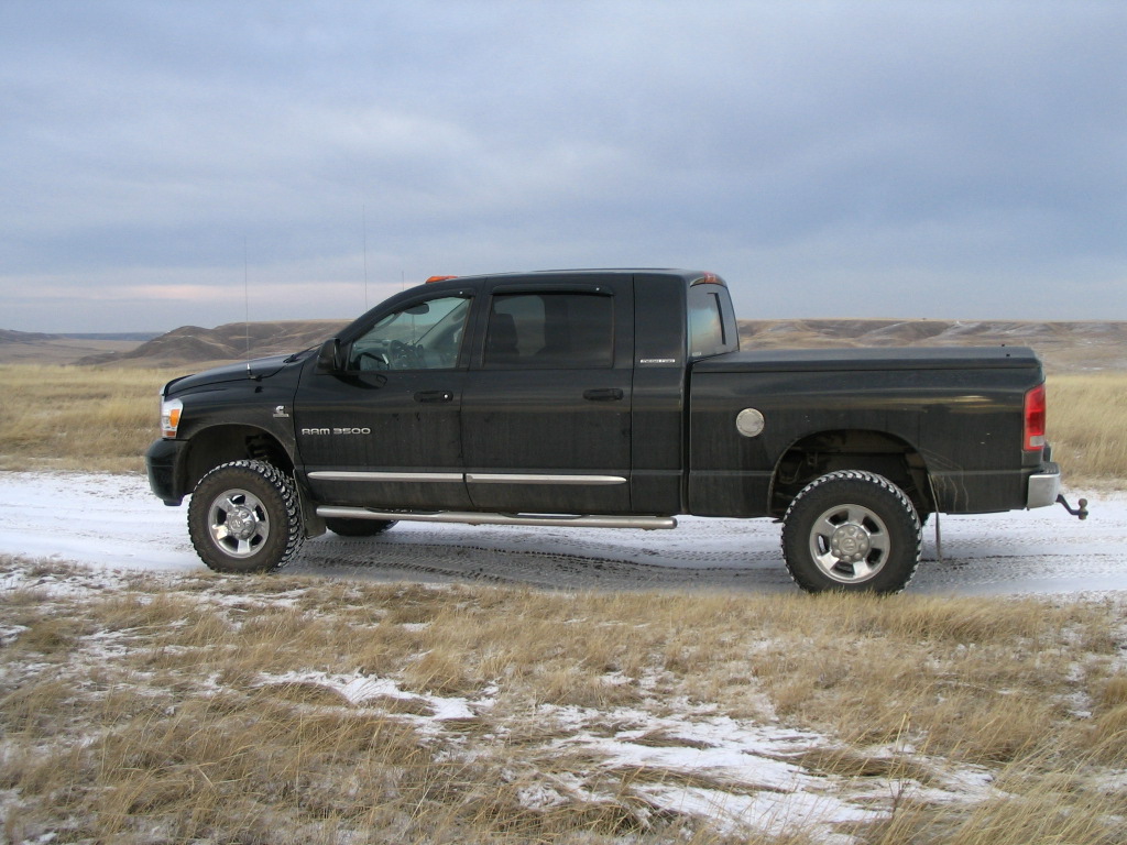

Here is a pick of my 06 with 2" levelling kit and 285's. Did the tires first, then levelled, and now I think that the tires look to much like 'pizza cutters'.
