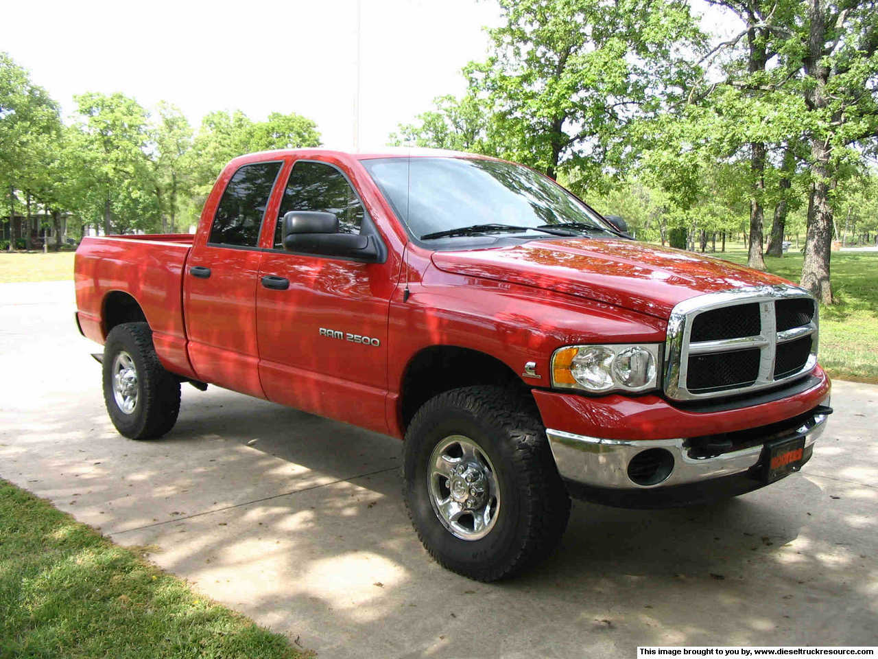

i have 315/70/17 on mine no rub at all, i have not done anything with the suspension. i have pics in my gallery.
