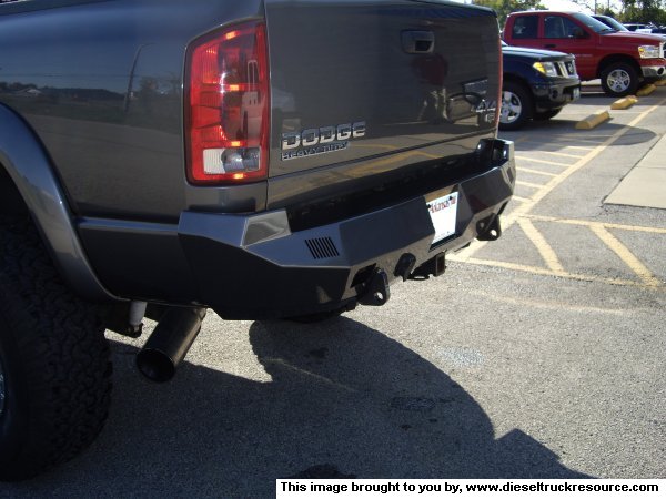

It does not move the stock receiver at all. It utilizes the stock set-up and is notched just over the top of it. I have the stealth bumpers on my truck and with a 5"s of lift on the back and 37" tires I use anywhere from an 10"-14" drop hitch to make it work.

They only problems I have are running the locking pins for the hitch. I am sure if I adjust my bumper down or out a little bit I could get them to work, but I like to have it snug and boddy lines exact... So I just run a regular hitch pin.
Here is a pic showing a decent contrast between hitch and bumper just don't mind the snoozing...

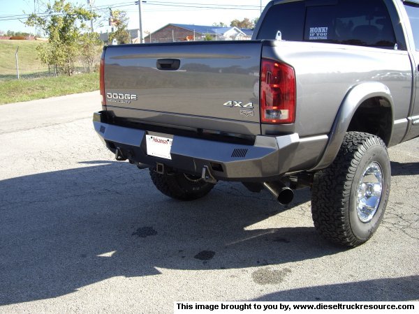

CrashCade is right on all accounts. It doesn't change the receiver hitch at all but using hitch pins is tougher. I don't like to leave my adjustable receiver hitch in because it looks stupid hanging down so far, but thankfully I don't pull trailers much this time of year so it's not a big deal to put it in or take it back out.
CrashCade, did you have to drill your own holes for the license plate lights? I still haven't done mine and I think it's kind of odd that I spent so much on two bumpers only to have to drill holes in them to make them legal. They even sent me the lights with instructions on how to drill for them.
Well, I have the fair lead rollers in place and I just snap the license plate to those. Road Armor or Mile Marker had the license plate brackets. They sell Lighted license plate bolts. Just wire them up and you are good to go. Put a quick disconnect plug on it in case you need to remove your plate to utilize the rear winch!
