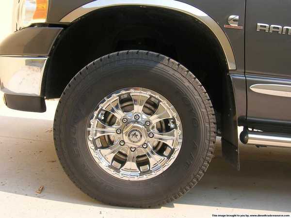

I have been running the Toyo, A/T, LD E, 285/70/17. Only got about 5k on them, so far so good. Looking forward to see how they do in snow.
[IMG][/IMG]
T398
