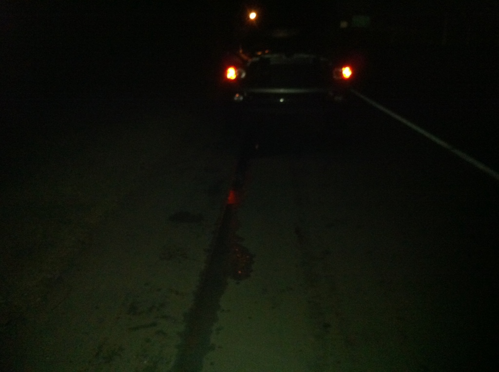

Right before I went to the house I did a roll-on in OD/Lockup.
I wasn't even to the floor yet and BOOM!!!
How I didn't crash I really don't know.
The truck was shaking horribly! It was actually still running, or trying to.
I had to leave it on to get over several lanes. I cut it off and costed the rest.

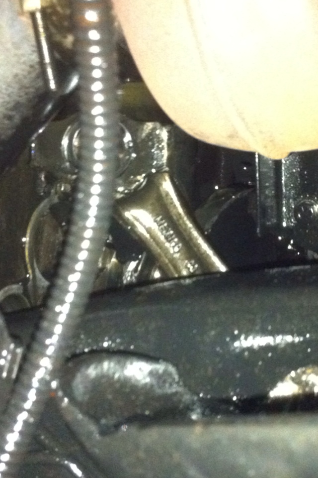

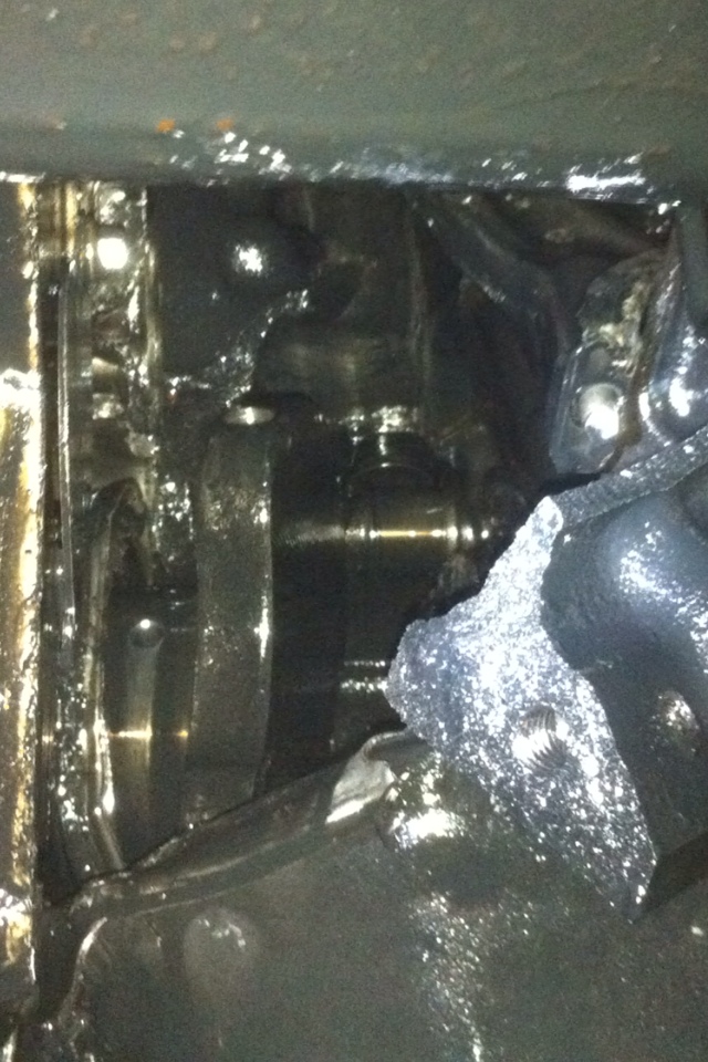

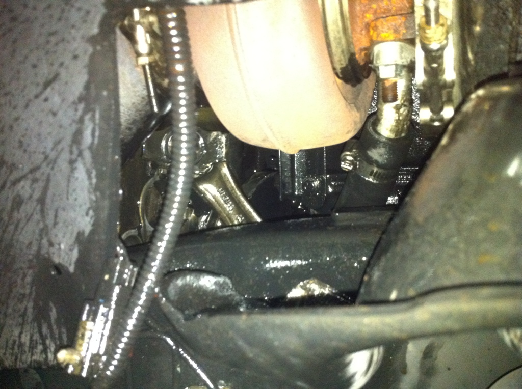

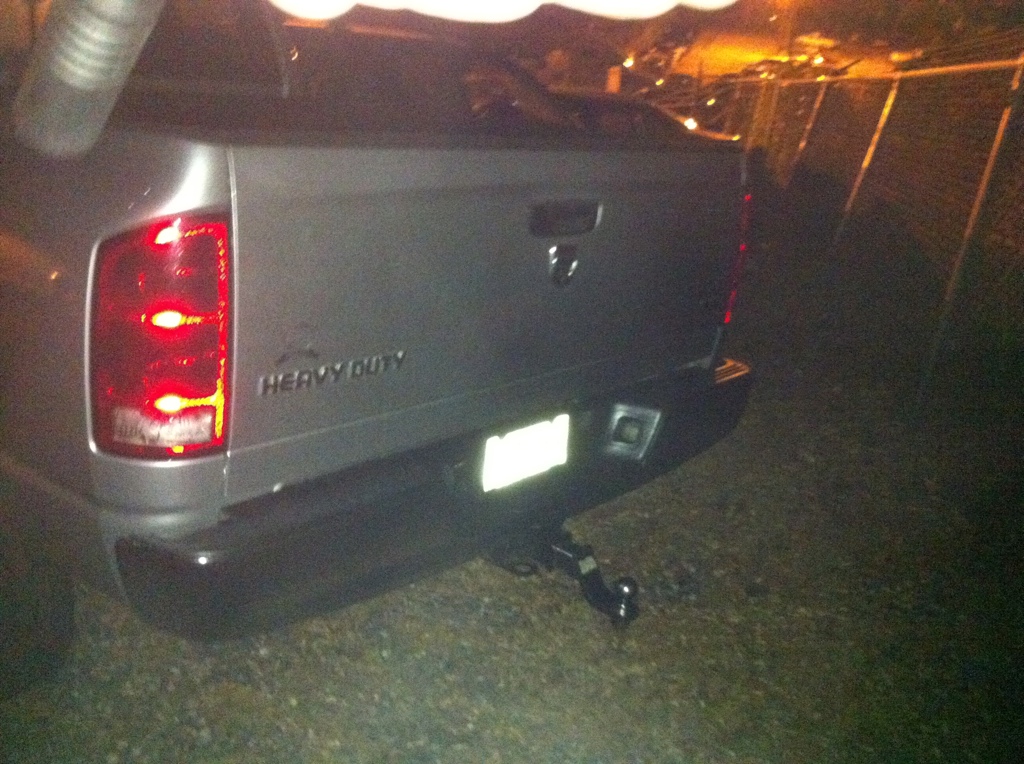

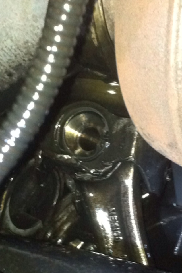

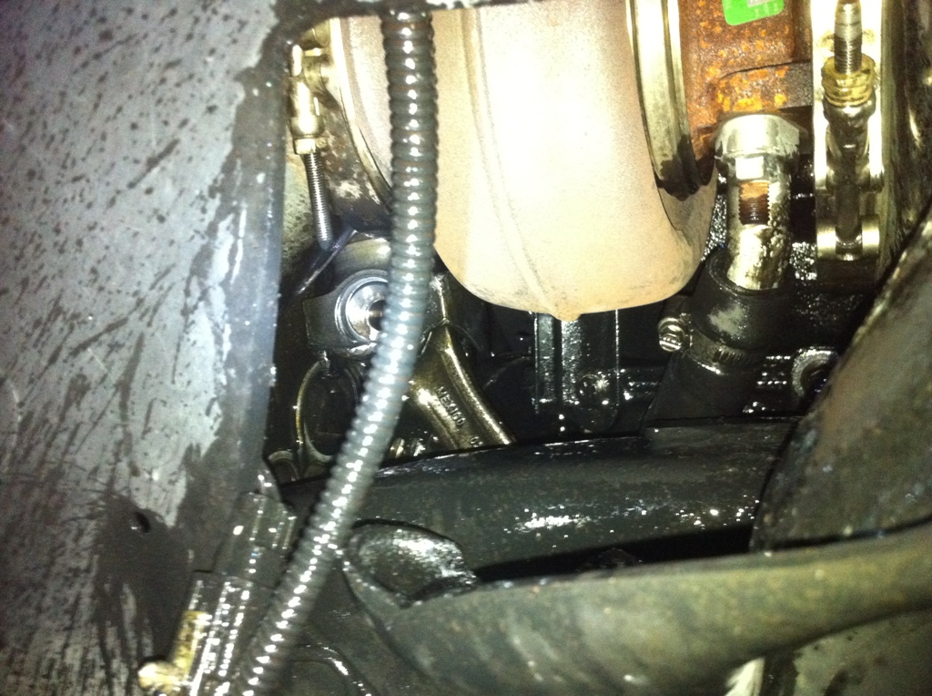

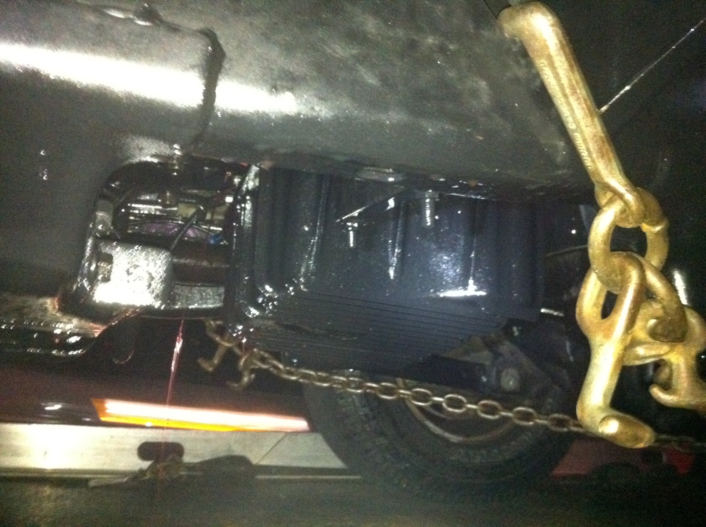

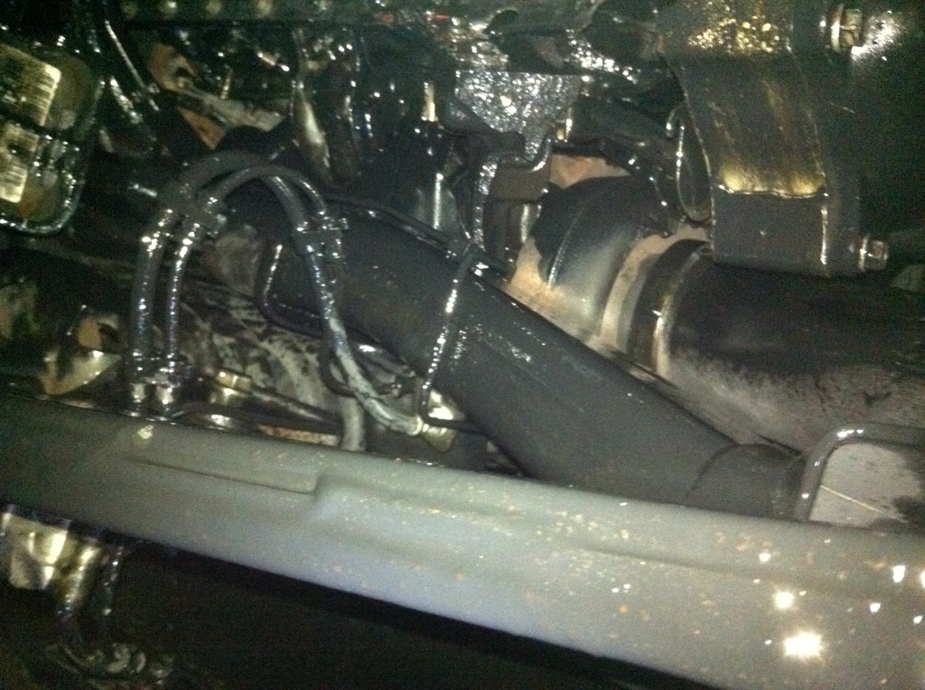

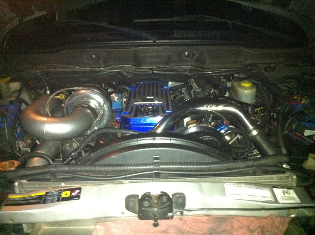

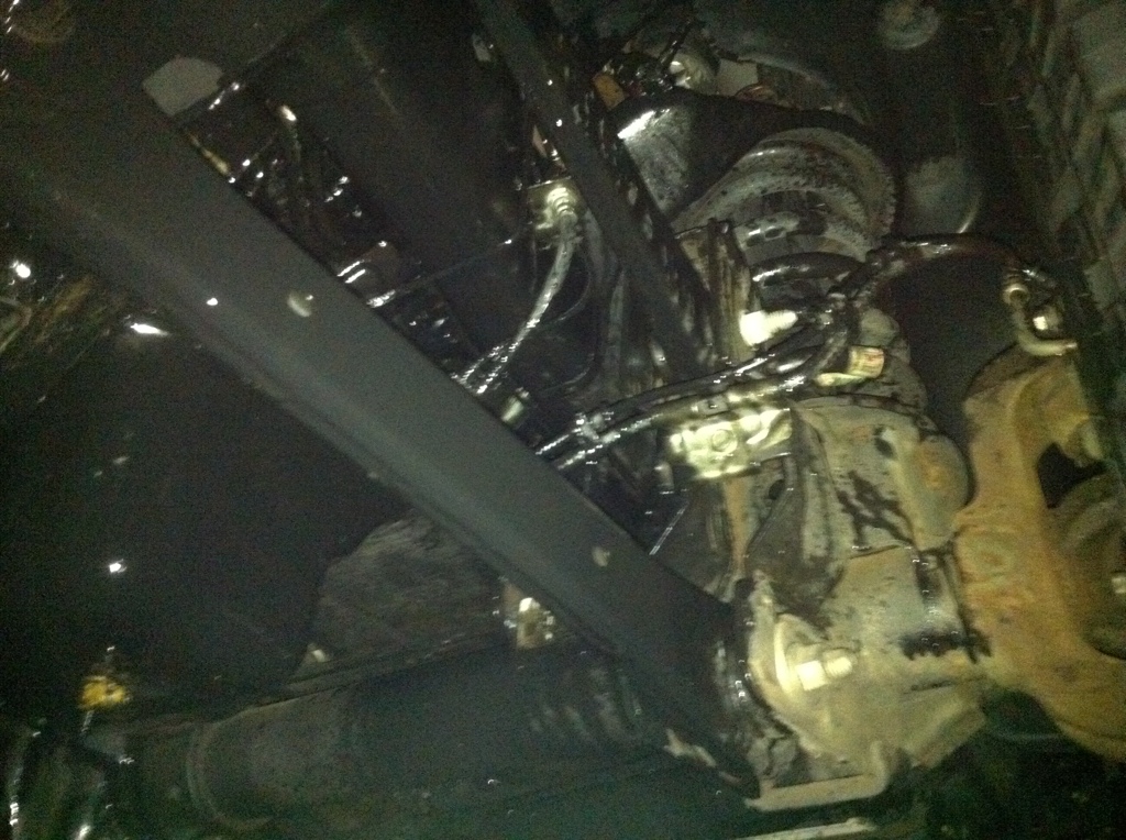

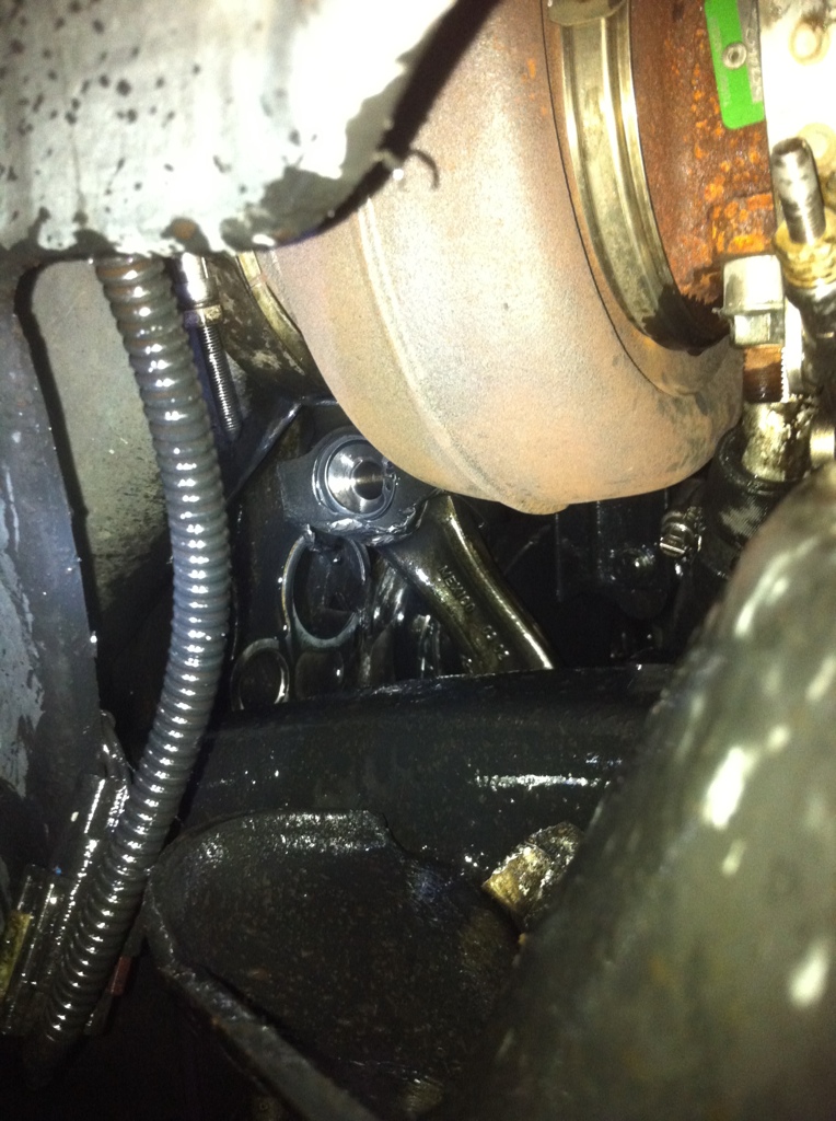

This is what I know so far. I'll start from the top down.
- Serp. Belt broken which too ou my fan wiring harness.
- Motor and trans is sitting at an angle now. Trans mainly.
- You can see a rod and Monotherm from the pass. Front fender well, but it's facing the wrong direction.
- Block is "SWOLED" Big Time on the rear pass. side.
- Blew out and ripped the oil pan.
- It looks to me like the rear of the Crank Shaft broke off abd thats what did the damage.
- It blew off the whole front of my tranny. I can see the flex plate and converter from under the hood!!
- The tranny is sitting crooked ( tilted to the side ) under the truck. Not sure why yet.
- Oil is EVERYWHERE!
It Is Edit up folks!!!!!
Here come the pics...

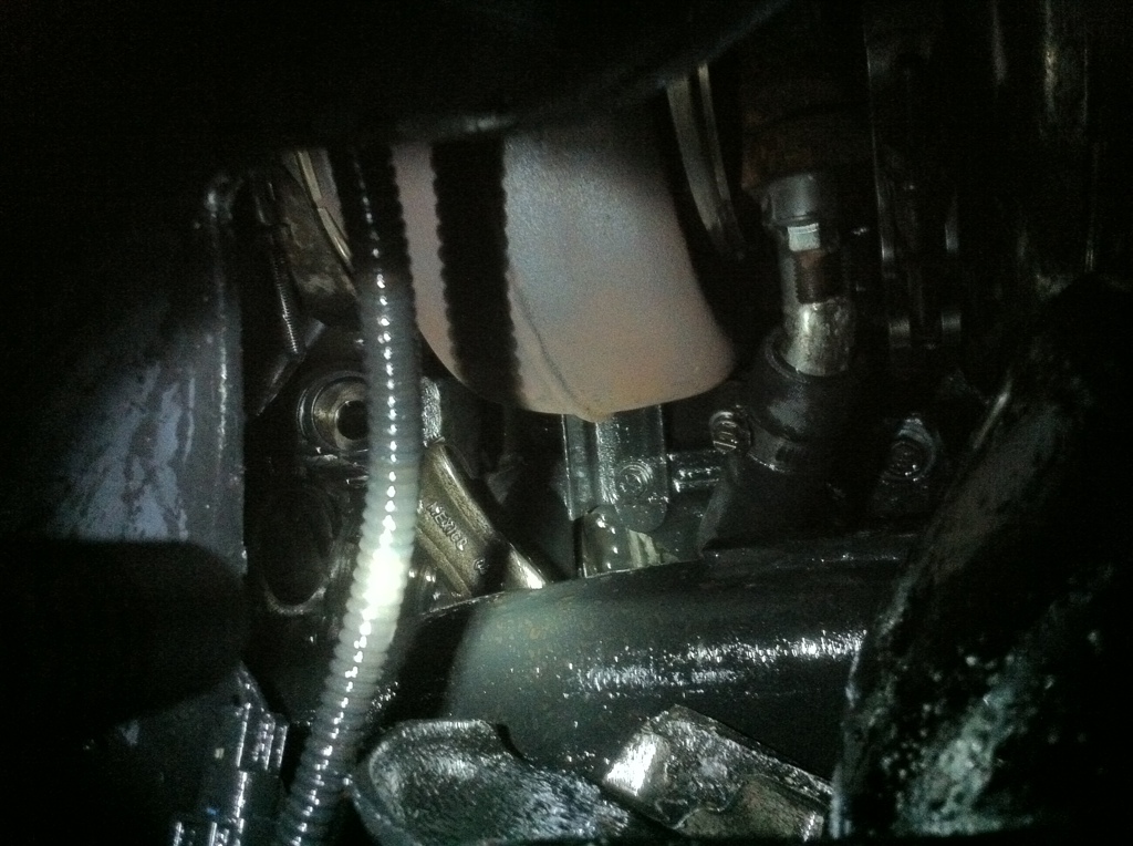

Old Sep 19, 2011 | 12:58 PM
Big Swole's Avatar
"Swole It like ya Stole It"
Joined: May 2011
Posts: 310
From: Just outside Atlanta GA

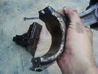

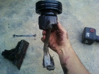

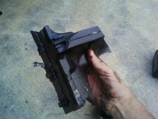

Broken Crank
Broken Rod
Window'd Block
Broken Motor mount
Serp. Belt broken
Fan wiring severed
Twisted the whole tranny hard enough to twist the tail shaft end in half.

Kyle (Jeff's employee) was able to pull these out of the motor / block from just sitting in the parking lot.

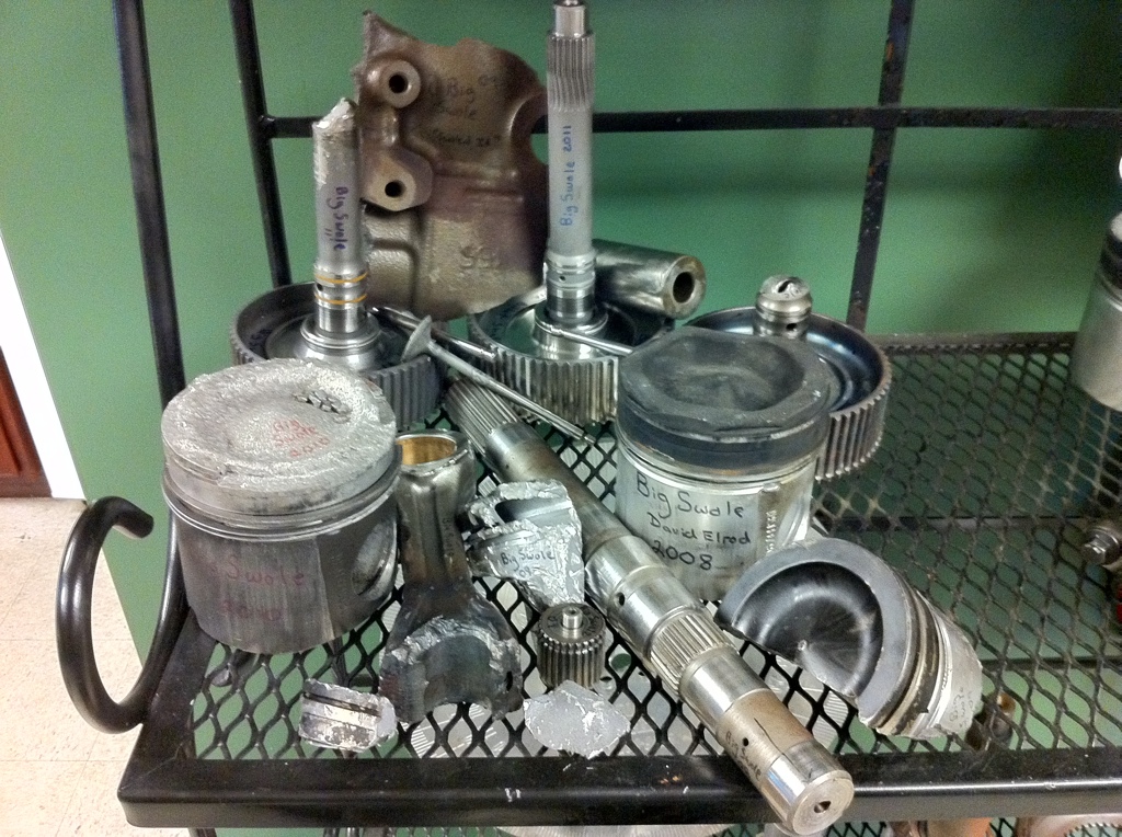

Some of it will fit on the shelf...lol
