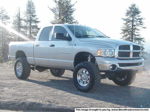

Here's a pic of my "crappy" lift

Sweet Rig BD! You are lucky to be with us after your wreck. Don't know much about lifts, but I have to agree that the quality of shocks play a big role in ride, just depends on what you are using it for.
