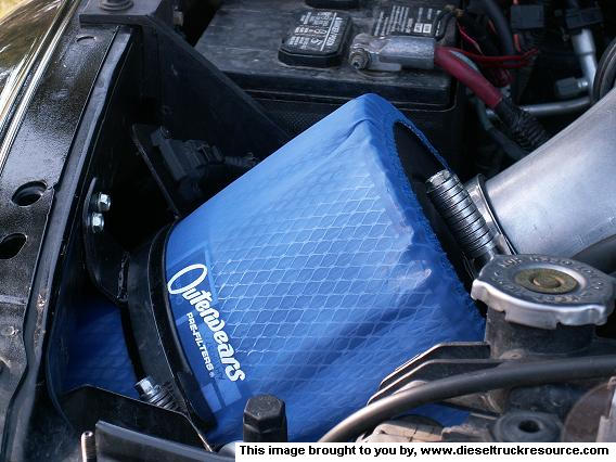

Thread Hijack!!
And a STOLEN PICTURE!!!
Hoss, I'm following your footsteps for now....Still like the idea of the AEM Brute Force torque tube....Whether with a Dryflow filter or a BHAF, havent decided yet...Anyway...
Who makes this fender mount for the BHAF?? Web search is fruitless
Did I say fruitless?

I don't know, but if you find out let me know. I'd like to see a picture of the tubing going to the filter too if you can find it. Who's image gallery did that come from?? I have questions for them.

That's slick. I was going to use a 45 degree bend but I think the way he did it with the 90 degree bend might work better (and give you more room to play with).
