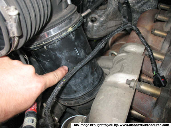

i have a couple Questions how do you get the fins out of the air intake tube with out messing anything up?

If you look at the tube that is straight and smooth, there is a little lip on it. You have to pry it apart with a small screwdriver, and then the baffeles will fall right out. You will need some 2 part epoxy to put it back together.
Tube:
Baffeles:
