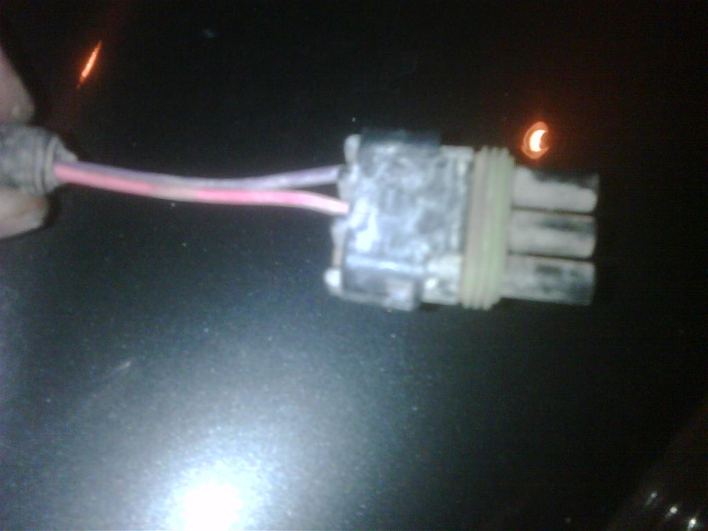

also, maybe QUAD can chime in and let me know why this connector wont fit my coolent temp plug. This box came off my old truck, also an 03, but this plug on the truck is smaller then the plug on the box...... Plug on the truck is a small 2 wire plug and the plug on the box is a large 3 wire plug with only 2 wires on it.

First picture is the plug on the quad box.
Second is the coolent sensor on the truck

Post a picture of what the box looks like. That looks like the older xillerator std. harness.

It is the old one. Built on 05. Yellow box. its way cold outside (5 degrees) so a picture wont come tonight

That means you don't have a wire that connects to the cooling system. My old box was Green, the newest boxes are black. You have two plugs that you need, the map sensor and the high pressure sensor, that's it. As far as the switch, perty sure you gonna need that. Give Quad customer care a call.

Odd. I have the MAP and rail pressure sensor plugs, pluged in already. Obviously have the switch plug open. and have that one remaining.
Any idea what its supposed to be for?

Yes, it was a data link cable plug I think. That's been a long time. Tape it up, you don't need it.
