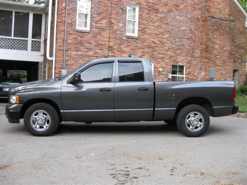

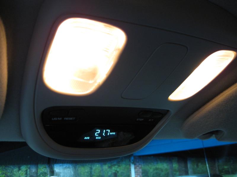

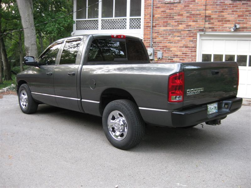

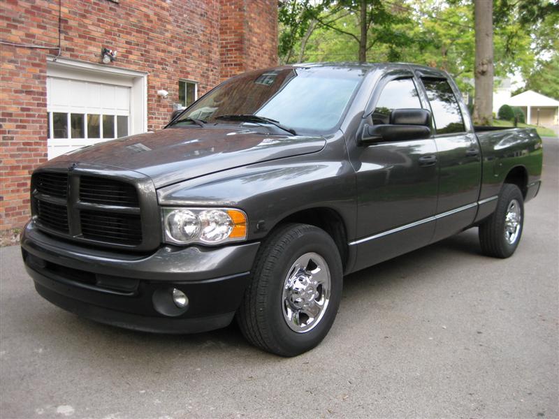

Hello to the board! I have been a 2x CTD owner and love the package. I have finally got around to posting some in progress pics. I just installed a 0-70-100 quad switch box I found on ebay. It makes quite a difference. I always run on the middle setting and when feeling punchy I switch it up to the 100 setting. I cant seem to get over the fact that I can roast the tires on a 6000#, four door rig and get 20+ combo mpg's!! I also put powdercoated front and rear bumpers along with a painted grill shell. I am headed for an industrial look on the truck. I still need to put some powdercoated 20's and remove the rear overload spring. Thanks to all for the insights and ideas for this great truck.

Don't trust that lie-o-meter that resides above your rear view.. Theres a reason people hand calculate mileage on here. You may be getting close to 20, or even a little more, but for the most part they are totally wrong.
Half the time my 05 reads 26+, yet I usually get about 500 miles per tank combo city+highway. That's only about 16.5mpg.

Looks good. I like the black bumpers.

did you paint the chrome??? how did you prep it? i want to paint mines but i don't want the paint to start pilling off later on. looks good thou.

I took it to a chrome shop and dip it to get to a nickel base. Then etch primer prep and paint. The shell is body color and insert is black. Turned out good.

Basically you sand or sandblast the chrome off then prime and paint or powder coat. As you can tell I already have the same idea (he stole my look but I was going a step futher- I won't say until I get it done and yes I do my own prep/painting)

the over head is not acurate hand calculate you might not be so happy with milage.
