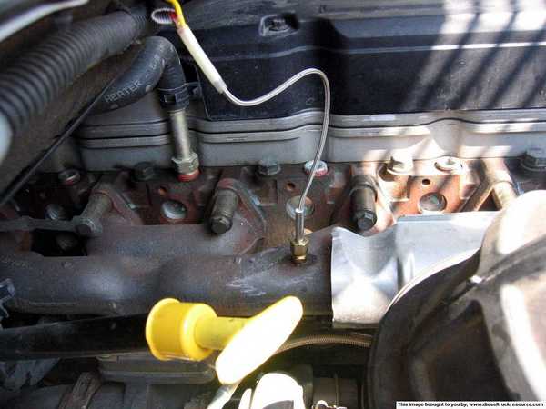

From: Twin Falls, Idaho
Here is a pic of both of my pyro's.
