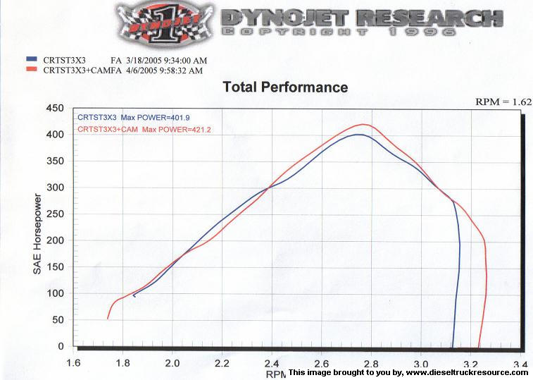

Before releasing a 3rd Gen cam Piers wanted some milage and horsepower testing done. Piers himself did some testing on his truck, but his was tested with twins and he wanted to test it on a truck that still had a stock turbo, and I volunteered to do so. My truck is a Cummins 600 04.5 Tier 3 emmisions engine. For milage testing I made sure I only did tests on long trips at a constant highway speed(70MPH) on the same streach of higway. After the cam install I have gained a solid 2 miles per gallon. I have registered as much as a 3mpg increase but 2mpg or a little over that seems to the average. The reason for the increase in fuel economy, as much of you already know, is that the 04.5 and later engines have a more retarded cam timing than earlier engines. The cam has also increased throttle responce quite a bit. I was expecting a little quicker spoolup on the bottom end, but the cam just seems to let the engine breath better... kind of feels like opening up the exhaust on a regricted gasser. Of course yall know me and i did dyno testing before and after the cam install to see if the torque increased in the upper RPMs like Piers said it would an here is what I got.
Hope I don't have problems with these links, here is the Dyno Coparison of SAE horsepower with the TST box on 3X3 before and after the cam install. Also this is floing through a custom dual air filter intake and 4in exhaust.

Some people don't trust SAE corrected numbers(Like Me), and even though the temperature was almost exactly the same on both days, and this was the same dyno, I have a Dyno Comparison of Uncorrected Horsepower before and after the cam install.
https://www.dieseltruckresource.com/...Horsepower.jpg
Also I did a before and after with the TST turned off for a stock reading... I only have the graphs for the SAE corrected though.
I know Piers hasn't ground up a bunch of cams yet and I have know idea of when they will be available. I just wanted to let some people out there know that there is an option to increase the milage on these emmision engines. With diesel prices the way they are I know this will interest some people. I think there was a post a little while back of someone who installed a Schied diesel reground 3rd gen cam. I believe they saw about the same increase in milage, but they didn't do any dyno testing. Anyway if anyone hase an questions simply ask. If anyone would like me to post a link to the torque graphs just let me know... they are really right on top of each other in the lower rpm and the torque increases in the mid and upper rpm range.

High Ten, the cruising EGT's have dropped 50-75 degrees. I need to hook up to a load soon and see how well of an EGT reduction there is when towing.
Real Squash, there will be gains with the 3005/555 engines but they will be gains that are more similar to cams that are installed on 24V and old 12V engines. Mostly just EGT, midrange torque, and spoolup.
