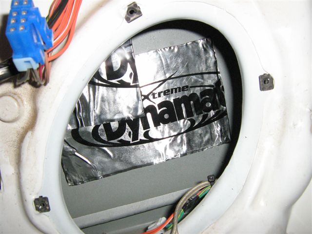

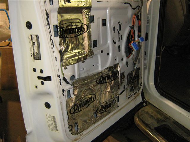

In this first post are picutures of the job Certified Radio in Edmonton Alberta had done when I asked them to dynomat my doors. The slapped on a couple of pieces and crushed my rear floor vent tube! I couldn't believe it!
