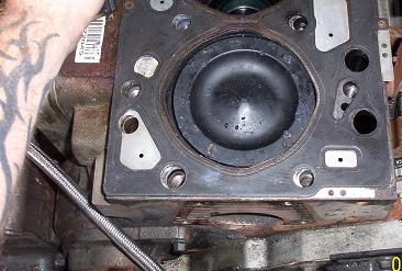

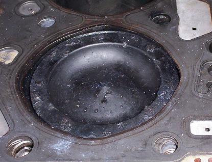

I had a piece break of the intake top plate. one of the ears that hold the intake horn down broke off on sunday and was sucked into #1 pulled head today found 3 small pieces of metal beat into the crown of the piston. but the cylinder wall is perfect and the head will be off to a machine shop soon. and with the help of Lmills and Tim Barber I will have it back on the road soon of course with a new helix cam and springs I hope to post pics of the block and head tomorrow

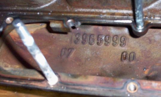

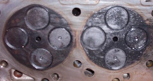

Here ya go Rob!
Attached Thumbnails it's broken it's really broken-k1.jpg   it's broken it's really broken-k2.jpg   it's broken it's really broken-k3.jpg   it's broken it's really broken-k4.jpg
