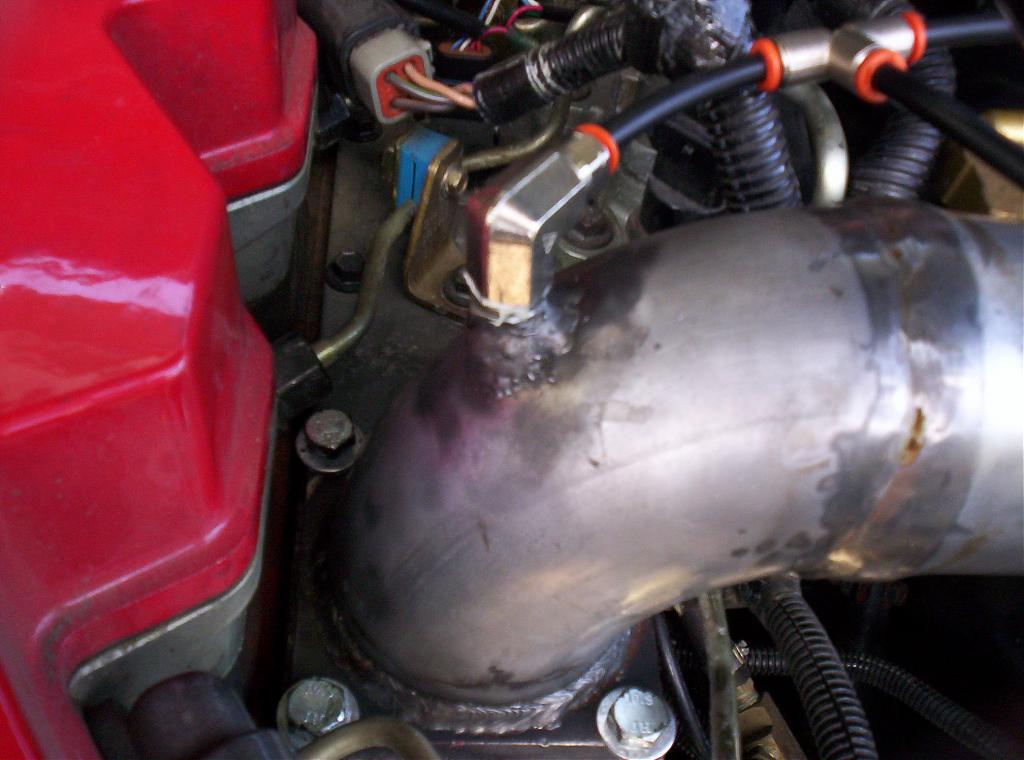

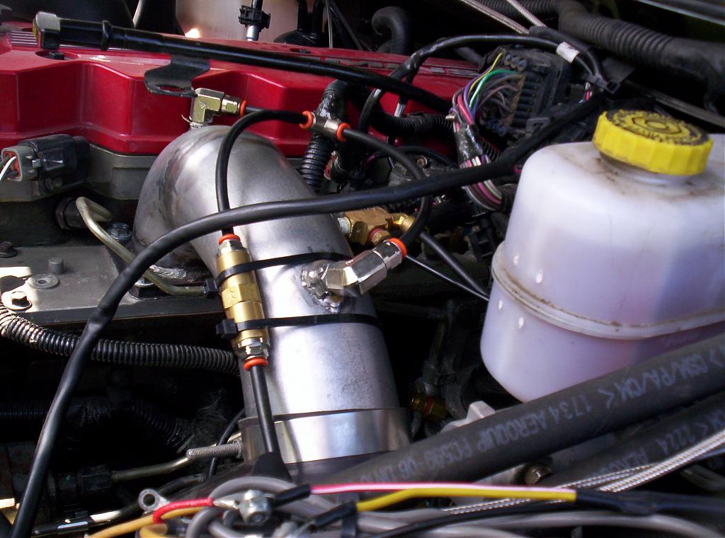

Here is how my Coolingmist is set up. I really want to find a different way to mount the controller but there is really no good place for it. I have the nozzles set up to spray as direct into the air flow as possible. I had them set 90* apart with the stock horn but the butt dyno says the current way works better. EGT's are the same with either set up.
P.S. the intake horn is a works-in-progress I used the windshield washer tank for my resevoir. I couldnt find a nice place to mount the 1 gal. reservoir they gave me. I would like to get a 6 gal. tank to mount in the bed sometime.

In theory, the spray will atomize better if it's directed against the air flow instead of with it.
You are right, thats what I thought. My stock intake horn looks like swiss cheese with holes and plugs. I am just going by what my butt-dyno tells me but it may need calibrated. We all know where theories get us with the CTD though.....

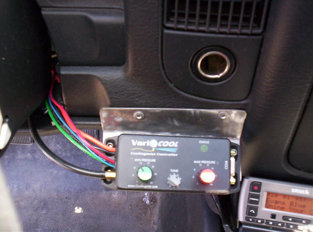

i put the tank behind the driverside battery, and the controller under the dash, i made a braket and a hinge, so i can turn it up, underneath the dash to keep it out of sight, and easily pull it down so you can reach it and see it to adjust it from there. it turned out nice IMO
