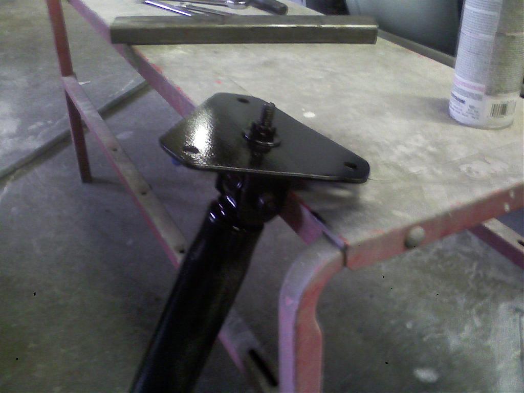

take your exhaust off first, nothing makes you madder than the first time you lift a dodge and the exhaust is in the way of the bolt for the top trailing bar on pass side. so just be prepaired for that. also shock tower on driverside is a little difficult to monover around the battery and two hard lines. you dont have to take the batt out you just have to kinda rotate the tower till you get it, its like a puzzle. this is my forth time lifting my truck so this time i made a plate like in the pic. to make things way easyer and also gives you 3.5 inches more of travel on the shock.
