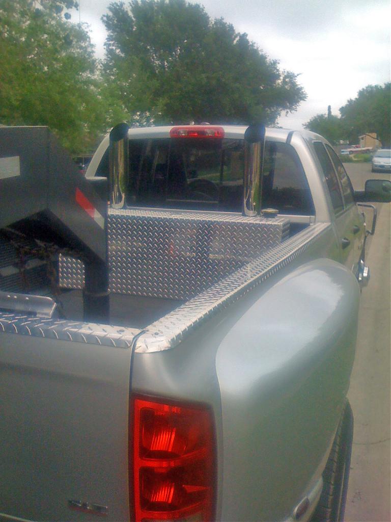

This works great with a 4" Magnaflow or a 4" HushPower. Gives a real "ballsy" sound. It wil also wake the neighbors.
Attached Thumbnails How th get rid of the raspy exh. noise?-img_0362_edited.jpg
