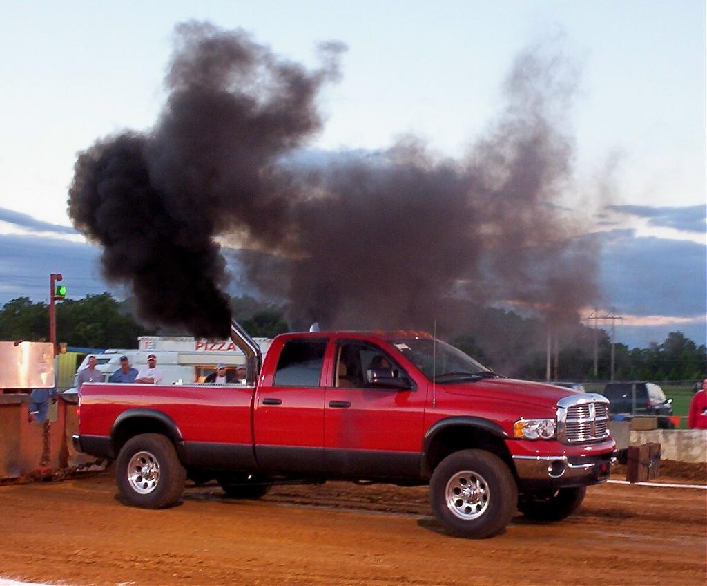

https://www.dieseltruckresource.com/...3&d=1194702730 cant get mine to smoke either
