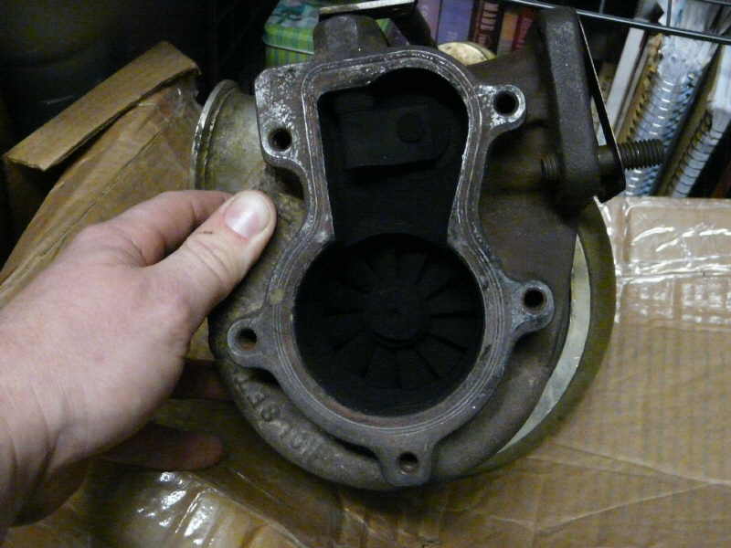

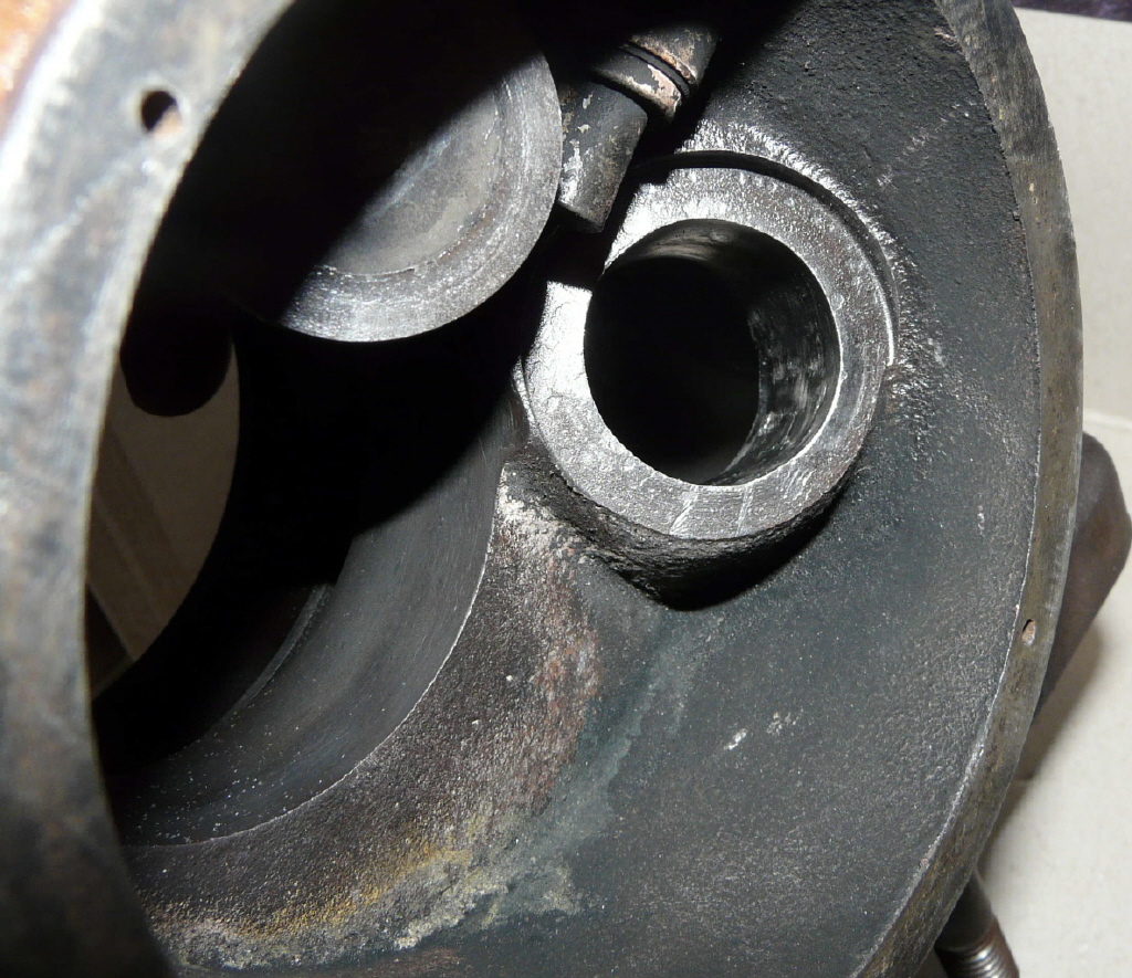

Ah64 is wrong about the ecm, when the ecm wants to limit boost, it de energizes the solenoid so that it no longer vents boost pressure. Once 26 psi pressure hits the wastegate head, it pushes out the rod. The rod leads to a lever connected to wastegate puck, flapper, gate, whatever you want to call it.
Here are some pics of my HX 35 so you can better understand the mechanical portion of the wastegate:
Attached Thumbnails How do 3rd gen wastegates work exactly?-1hx35.jpg   How do 3rd gen wastegates work exactly?-2hx35.jpg   How do 3rd gen wastegates work exactly?-3hx35.jpg   How do 3rd gen wastegates work exactly?-hx35.jpg
