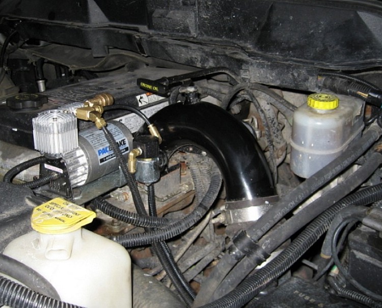

What the heck, I'll add mine...made it a few years ago...
