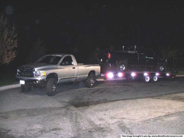

this is 35's with a pro comp 2 1/2" leveling kit and 2" blocks in the rear. if your going to be towing alot with it you might want to think about either air bags or a timbern kit to keep the rear from saging
