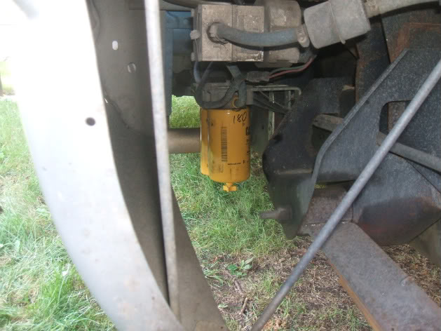

Pressure side:
Pic of my set up:

Pic of my set up:
The 750's look much shorter than the 749's. I will use the 749 first and probably use 750's from then on. You also mentioned the 749 has higher flow rate. Is that an advantage or will the 750 be fine?

Yes the 749 has a higher flowrate but it is designed to be used on engines three times the size of our engines. So it is a bit overkill, the 750 is more than enough IMHO.
