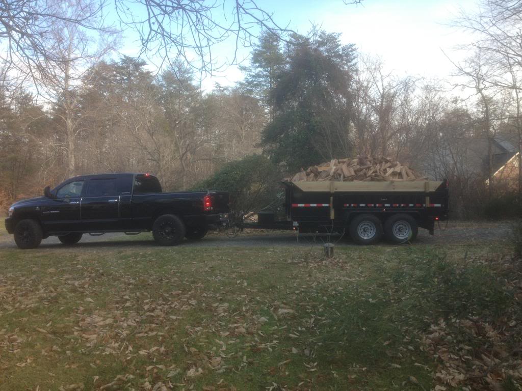

Ok towed a lot lately, 10-12k+ and I have to say my setup has impressed me. I am more comfortable towing heavy with this turbo/tuning than with my big truck with compounds and the works. Now on my big truck I didn't have EFI so smoke and water temps were always an issue towing heavy. I have been towing this weight with my 1 and only EFI tune, no switching anything. I will try to post up some pics later of my truck and dump trailer loaded.
Towing is not an issue with this charger. Temps are not an issue, and water temps never got over 205 and I was working her pretty good.
And that's the light load with dry wood. I haven't gotten pics of the trailer loaded with the big green oak stuff.
