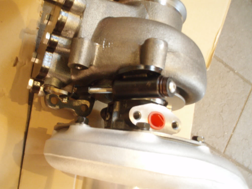

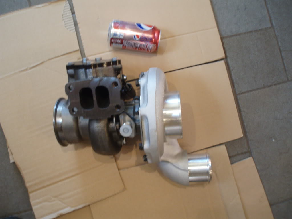

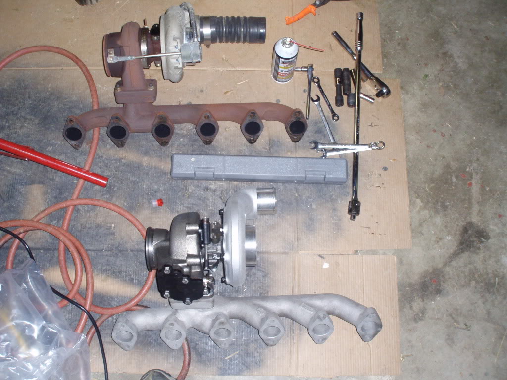

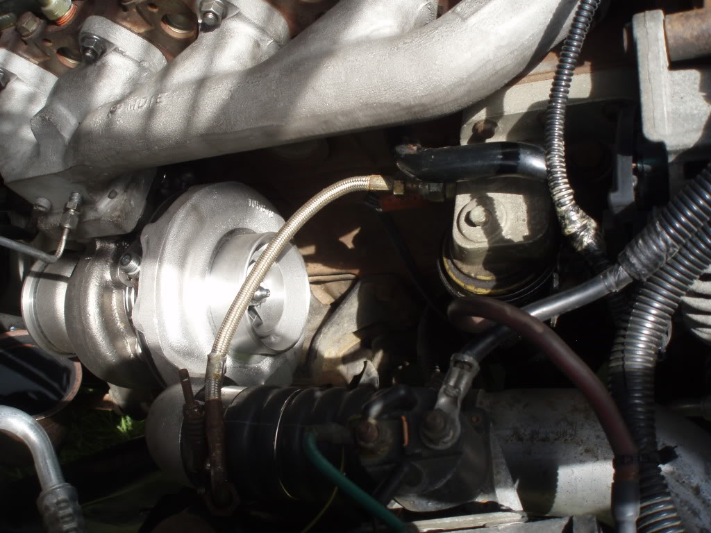

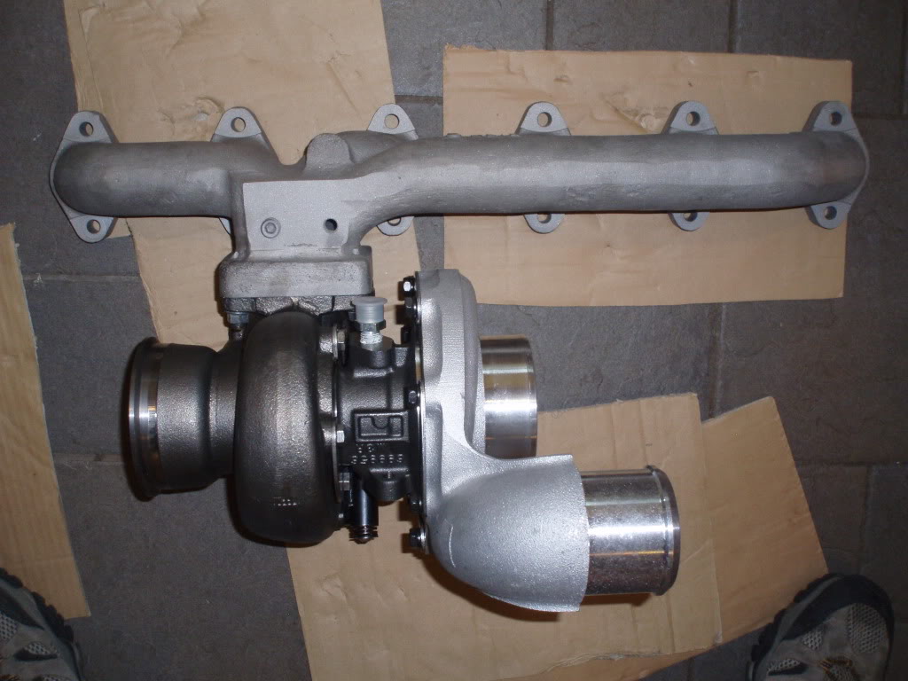

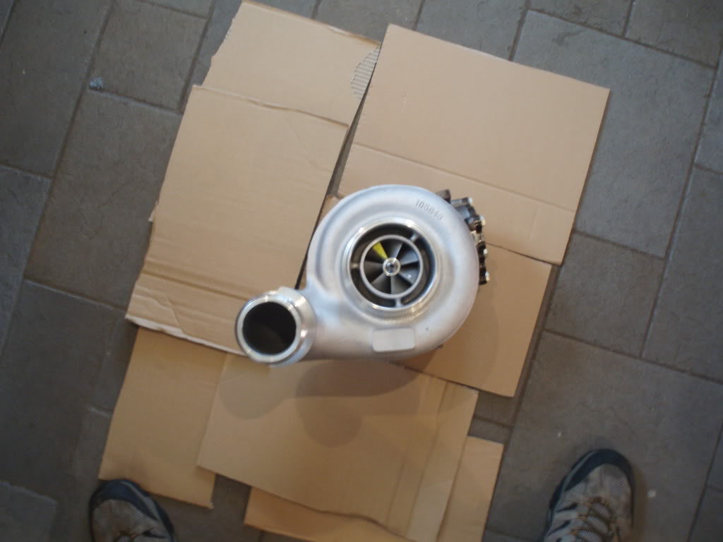

Very nice. Is that a SS exhaust housing? Who's manifold is that?
Oh, I can see all of your teeth coming out of your mouth, Devil! Haha... looks good, have a good time!
Old Apr 7, 2012 | 04:12 PM
RyeThomas's Avatar
Winner winner chicken dinner!
Posts: 1,613
Likes: 11
From: Northern VA
Manifold is Htt stainless, exhaust housing is not stainless, Compressor is unpolished SS. Good times, if Diesel wasn't $4.25 I'd be out running her.

Looks good! Engineered Diesel supposedly has some wild stuff that works great! What other mods do you have that helped you lay down 600hp?
And, correct me if I'm wrong but, you might want to move your EGT probe to the back port. You want to be reading EGT's of the back 3 cylinders, not the front 3.
Old Apr 7, 2012 | 04:38 PM
RyeThomas's Avatar
Posts: 1,613
Likes: 11
From: Northern VA
I did not lay down 600, that's the rated hp+ some. Heck I have stock sticks in this truck. As far as egt probe I put it their and in a few weeks i will move it back to compare and see what the difference is. Which ever logs higher egts is the spot i will leave it. With stock stick egt's are the least of my concerns.
Oh and this manifold runs a little different, you can't see it in these pics but 5/6 are more separated where on the stocker 5/6 seem to more or less share the same passage.
