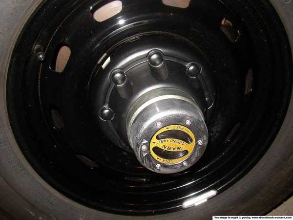

Some guys were talking about doing hub conversions on another forum and I offered to bore their hub caps out free of charge as long as they paid shipping. One guy took me up on it after a few pm's, phone calls, and a some waiting on UPS the results are below. Just helping out a fellow Dodge/CTD guy. It's not a big job only takes about 10 minutes per cap to bore the holes and maybe he saved $75 ?? to have a machine shop do it. His truck is an '06 2500 with, I think they are, 1995 or so wheels and hub caps. He's looking to get some 305's on there when the stockers wear out. He's real happy with it all on there. Here they are finished job pics and lathe pics doing the caps:

Some aftermarket wheels with the right offset will tuck them in a little more. They stick out way far on his truck with those 265 tires. Dynatrac's stick out 2" past the end of the hubcap face and EMS stick out 2.250" I think they look good on there you just have to be mindful offroad. My hubs don't feel loose or anything but I'll sure be keeping an eye on it. I've eyeballed the Ford hubcaps but never had a chance to put some calipers on them stacked they "look" to be a little small for our setups. Here's a closeup I didn't get posted last night. I bored the cap holes .060 over to give a good .030 clearance from this pic though it almost looks like a slip fit but there is a small gap there..
