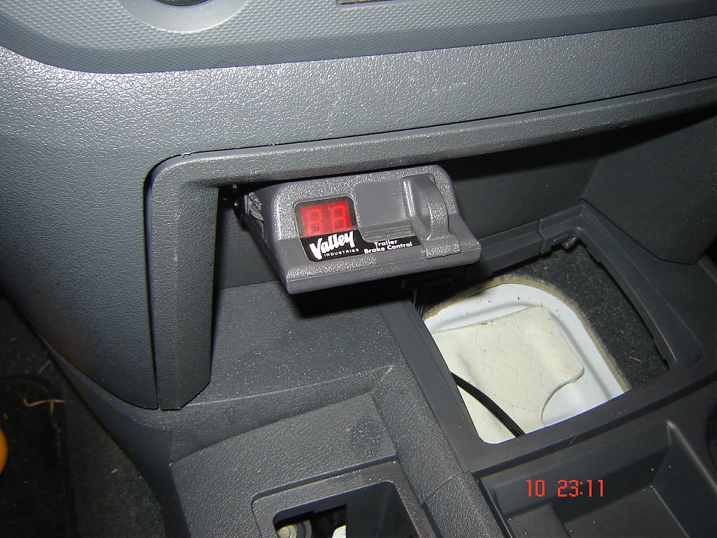

my wife was beating her knees to death on the brake controller under the steering wheel, so i moved it to the center console.

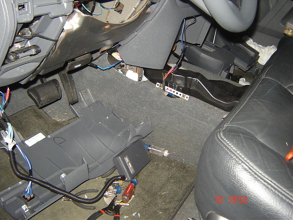

and i was tired of laying in the floor to plug and unplug the electric brake controller.
it seemed i always had to do it in my nice clothes.

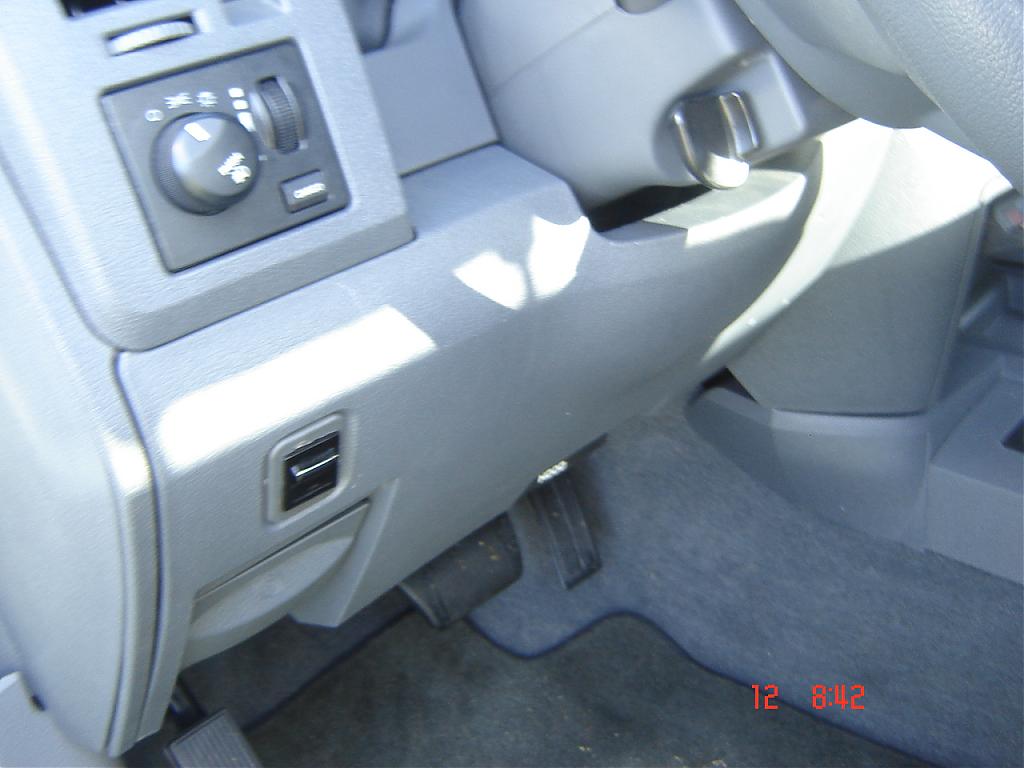

so i Put in a double pole/double throw switch.
one pole is for power to the e-brake, and one is for the power applied when you mash the brakes (the 12v to the light switches)
so you have to break two circuits at the same time.
and i put the switch in the place of the "power pedals" since my truck was a stripped model.

mine has a heavy duty relay that makes a big clunk when it applies the trailer brakes, and it gets annoying,
and the display had a read out that indicates an open in the circuit, it just gets annoying REAL QUICK.
