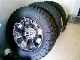

I ordered a 6 in. fabtech lift for my truck. The shop thats doing it recommended fabtech or bds,but they leaned more towards fabtech. You guys think I made the right choice? Heres my whls/tires.

Are those Mazzi Hulks? Good lookin wheels.
Old Jan 1, 2008 | 11:52 PM
06CTDforAU's Avatar
Posts: 1,126
If those are Mazzi Hulks you're gonna have some rubbing. They are all 10" wide with 4.5" backspacing and those Toyo's are some wide rubber. You MAY get away with it if they are 35's, but if they are 37's you're gonna have serious rubbing. Especially since the Fabtech lift is only 4.5". It's only 6" on the 1/2 tons.

I thought they only made a 4.5 also. But I got on their website and they do have a 6 in. kit. The wheels are 22x10 mazzi hulks and the toyos are 37s.

you gonna have some major rubbage!!
good luck, time to break out the sawzall!!

You are correct. I just looked on their site and they do offer a 6" lift now. I guess they just started making it. So, I retract that part of my previous statement.
However, you will still have rubbing issues with 10" wide wheels and 37x13.50 Toyo M/T's. Those are the widest 13.50" tires I have ever seen. Some of them are nearly 14.5" wide if I remember correctly.

I might have to leave in my spacer from my leveling kit. Think that'l hurt anything?

i have a 1 1/2" spacer on top of my 2" springs and it's been all good for over 1 year.

I like the wide bulldog look,but I guess my fenders are gonna take a beating.

Agreed. I love the look too, but the truck really takes a beating. I ran 325/65/18 Terra Grapplers on 18x9 Moto Metals with 4.5" backspacing and it looked awesome, but the wide tires/wheels really ate the paint on my truck even with flares installed.
As for the spacer, it's not the best thing to do in my opinion, but in most cases it works just fine. I wouldn't recommend it if you are doing a ton of offroading, but that's just me.
