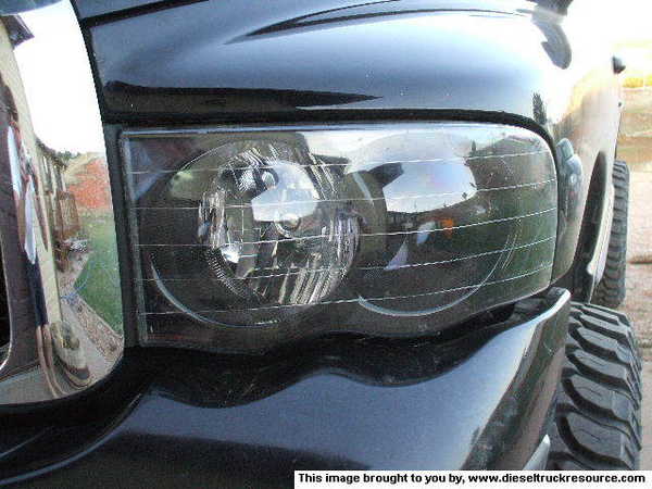

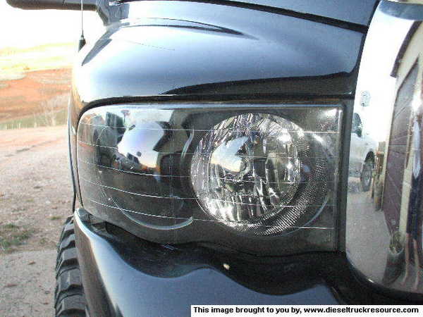

Old Apr 17, 2007 | 09:20 AM
OldSmokey's Avatar
Joined: Apr 2004
Posts: 1,609
From: Sturgis SD
Here are the pics. All that you need to do is pull the headlight housing, and bake it in the oven on a low temp for 10 or so min to get the glue to loosen up. Then start to pry it apart. The hardest part is getting all the glue off so i baked mine a few more times to help remove the rest of it. When everything is pulled apart clean the piese that want to paint well and spray it with the color of paint that you want them to be. The chrome stuff takes a little while cover so spray them quite a few times so the paint doesnt run. Let all the paint dry and put them back together, i used RVT to seal everything and have not had any problems.

I dont think it will work on the 06 and newer trucks. As for temp i dont really remember but I think it was as low as the oven would go. I wouldnt go over 200. You just need enought heat to get the glue to let go a little.
