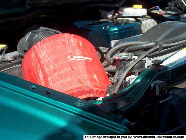

OK haven't posted or been on for a while but will a BHAF 2790 work on our 3rd gen 5.9 trucks? I currently have the S&B set up but really like that BHAF look, just seems like it would pull more air.

I put one on my 06. Kindof a tight fit but it worked. Worst part was getting the intake tube over the air filter lip.

I have one on my truck. I used all the stock tubing and just inserted a piece of 4" tube into the inlet of the filter and the stock tubing slips right over it. It is a tight fit though. The hard part is installing the air temp sensor on it without breaking the mounting ears off of it since it has a flat mounting surface....

i just left the air temp sensor hanging. haven't had any problems. i had the stock box with a k&n filter. that is what was in it when i bought the truck. there is more of a whistle over the stock box.

I put one on my 05 and I can hear a big difference in whistle. I cut out my intake baffles and wrapped my coolant return line in helicopter wire. That will prevent the filter from rubbing throught the return line.

Yeah. It whistles much louder now. I pulled my silencer ring but have not pulled the baffles out of the tube yet. It will get even louder then.
You can leave the air temp sensor hanging off to the side and it will be fine as Blitz 81 already said. You just have to have the sensor plugged into the plug or you will get a CEL....
I had the stock setup before installing this. Just remove the airbox and the filter slides right into the hole on an angle....
