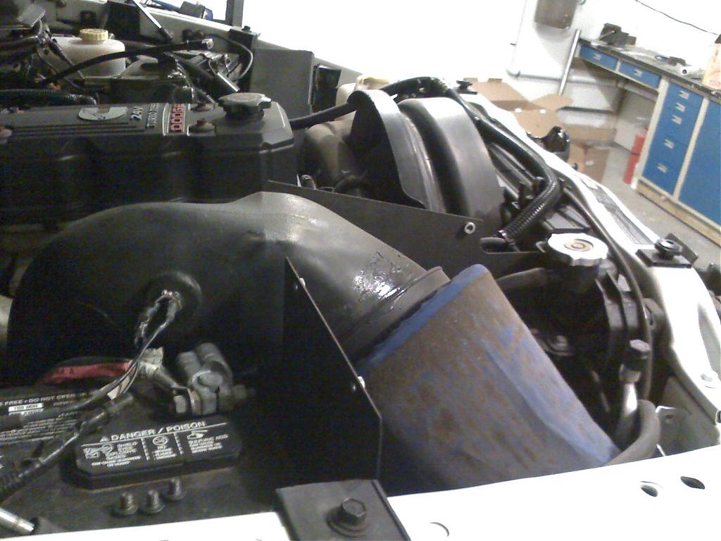

Here's some ugly pics
as I take out the AFE (cover is off). I'll post more this weekend from the install of the scoop.
You can see how dirty the AFE Filter skirt got after only a couple of weeks of use.
In the second picture you an see how the filter pleates got more and more bent from removal/install for cleanings/oilings. It never fit that great to begin with, the filter touching the box cover.
Th AFE is just a filter attached to the plasic tube, straight onto the turbo. No room for movemet/flex/vibration. Lots of gaps in the box too, namely at the front where the radiator (read: heat) is...

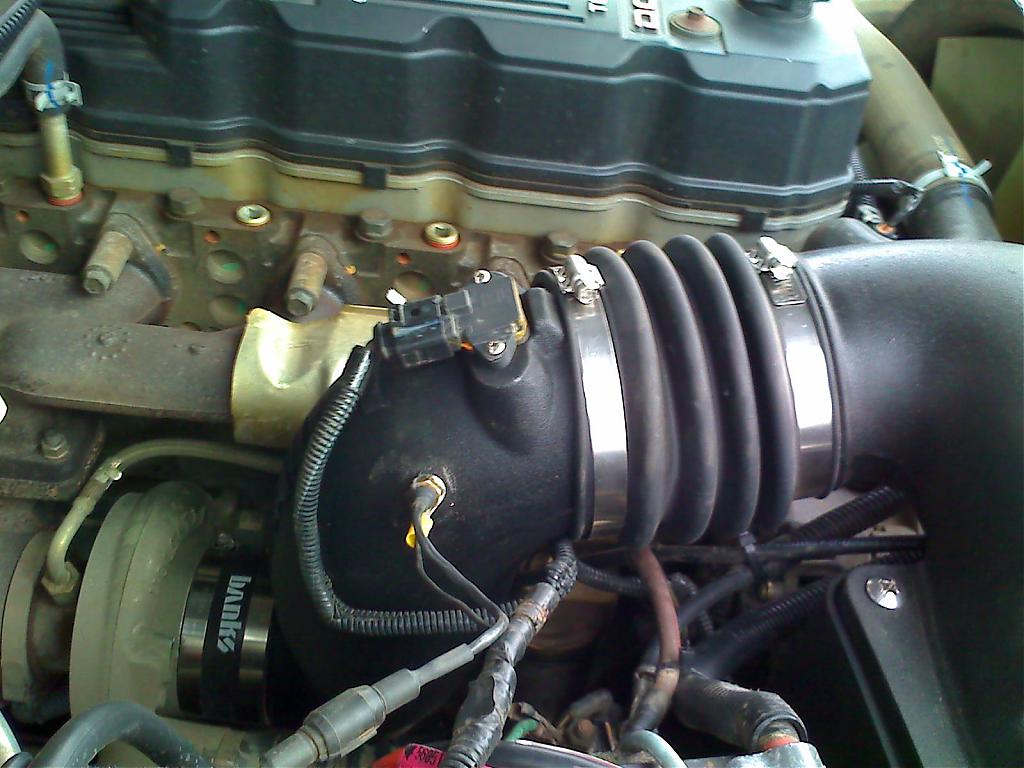

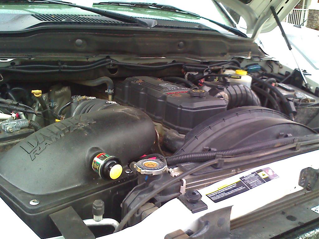

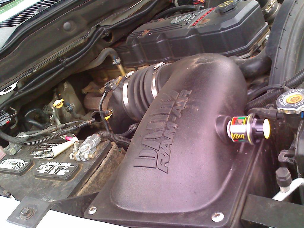

Sorry so slow...but here are some pics of the Banks installed, so you can see the difference.
