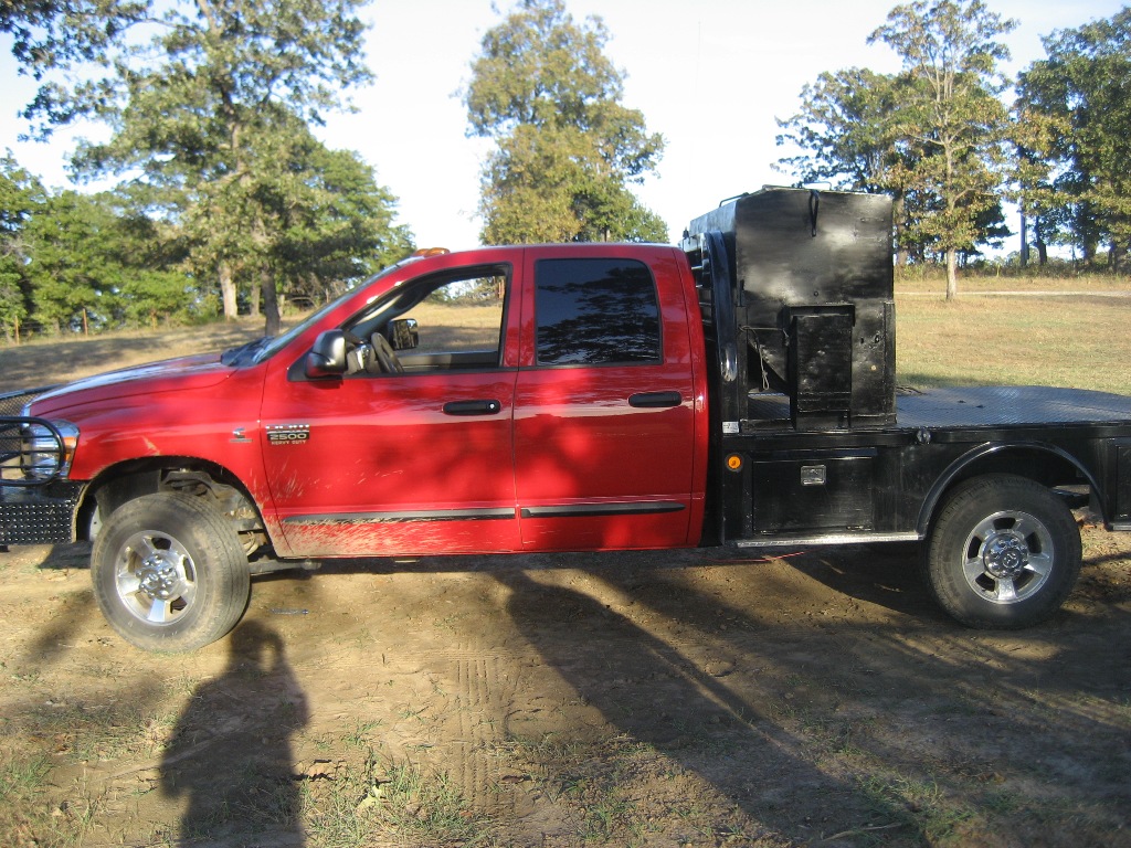

I have a feeder that goes on the back of my truck for feeding cattle the power supply wire to the feeder motor " starter motor" is #4 welding lead the power wire is broken at a solonoid that is mounted under hood that is closed or activated by a switch in the cab. I installed a fuseable link in the power lead to the switch in the cab what do I need to do to find out or how can I tell what the smallest amperage fuse that will close the solonoid and keep it closed without being too much. I realize there is always trial and error but If someone can tell me a quicker way I would greatly appreciate it. TIA
BTW I know its a shame to turn the RED ROCKET into a feed wagon but I have no choice it sucks to be a grown up sometimes.
