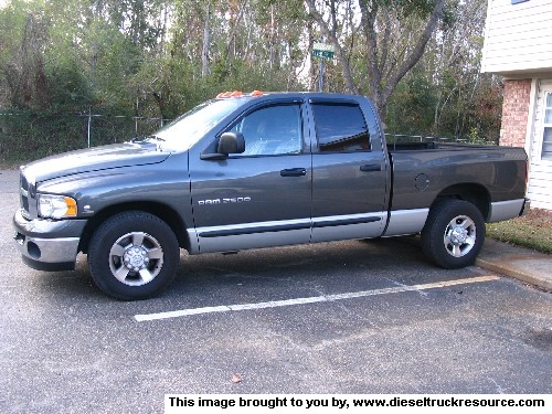

Daystar 1.5" spacers
Before
after
Before
after
Hey those pics are like the fat women in the diet ads. Tryin to fool us with the flares....
Looks good.
