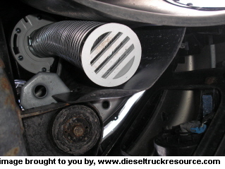

. Works fantastic. very pleased

I've havent noticed any extra anything other than actually being able to hear the intake, over the whistle and the straight exhaust. But I am currently running a stock replacement filter so I believe if you were gonna gain anything with this mod you'd need a better flowing filter to take advantage of the extra inlet. Theres a website that charges like $99 bucks to do the same thing and they claim it's main achievement is lower EGT's while towing.
