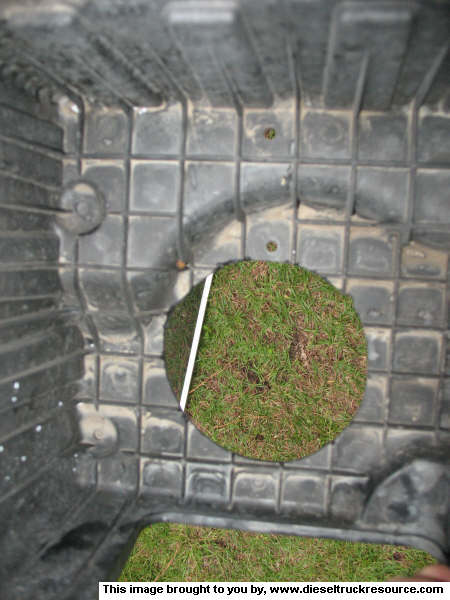

Try either swiss cheesing your air box bottom, or cutting one large hole and making a cold air pipe for it.
You can also remove the baffles out of the intake tube.

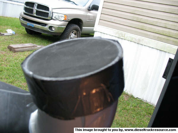

The filter minders are not known to be accurate. I could pull mine down simply by making a hard pull even with a new filter. Nothing wrong with a better intake though. I made my own with parts from Airflowonline.com
