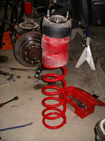

The Tuff Country lift makes me giggle because it uses 6 inch coil spring spacers. Yes, you retain the stock spring rate (which I think is too stiff, personally) but look at the extra stress. You are also creating another weak point. Before, the spring was one piece. Now it's basically two pieces, with four weak points.
To me, putting on a 6 inch spring spacer is like putting on a 6 inch body lift. They are both okay in moderation but there is a point where they are too tall and create too much leverage on the bolts that hold them in place.
Here is 6 inches worth of spacers.
I know what you are saying. I won't argue it. I even agree to a certain extent. I thougt I would have bought springs by now personally. I just go the lift so cheap I did not care. I just have not had the issue yet and have actaully been on the dunes, on the beach, in the mud a couple times.
so when I post in I am only saying it is not as bad as people make it out. I honestly though it would be a problem the first time I hit it very hard.
If I were really truely concered about strenght though, like you guy's say you are. I have not seen one lift that I though was just awesome that lifted 6". I have seen parts to make a sweet lift though. some of them are posted in eairler.

i had the 6" tuff lift and it was okay, but the thought of a 6" spacer and stock CA mounts is scary. with DJ's help i'm finishing up a 10" long arm kit. anyhow, 37's worked great with the 6" lift and 3.73's or whatever i have thats close to that. when its all said and done tho, springs and coils are way better and safer than blocks and spacers. but hell, i'm still trying to get my longarm setup finished. i run the 37x13.50 toyo mt's on stock rims and they work great. look in my gallery. rubs the CA a tiny but, but not enough to worry about. 15k on the toyos and they are halfway done.
