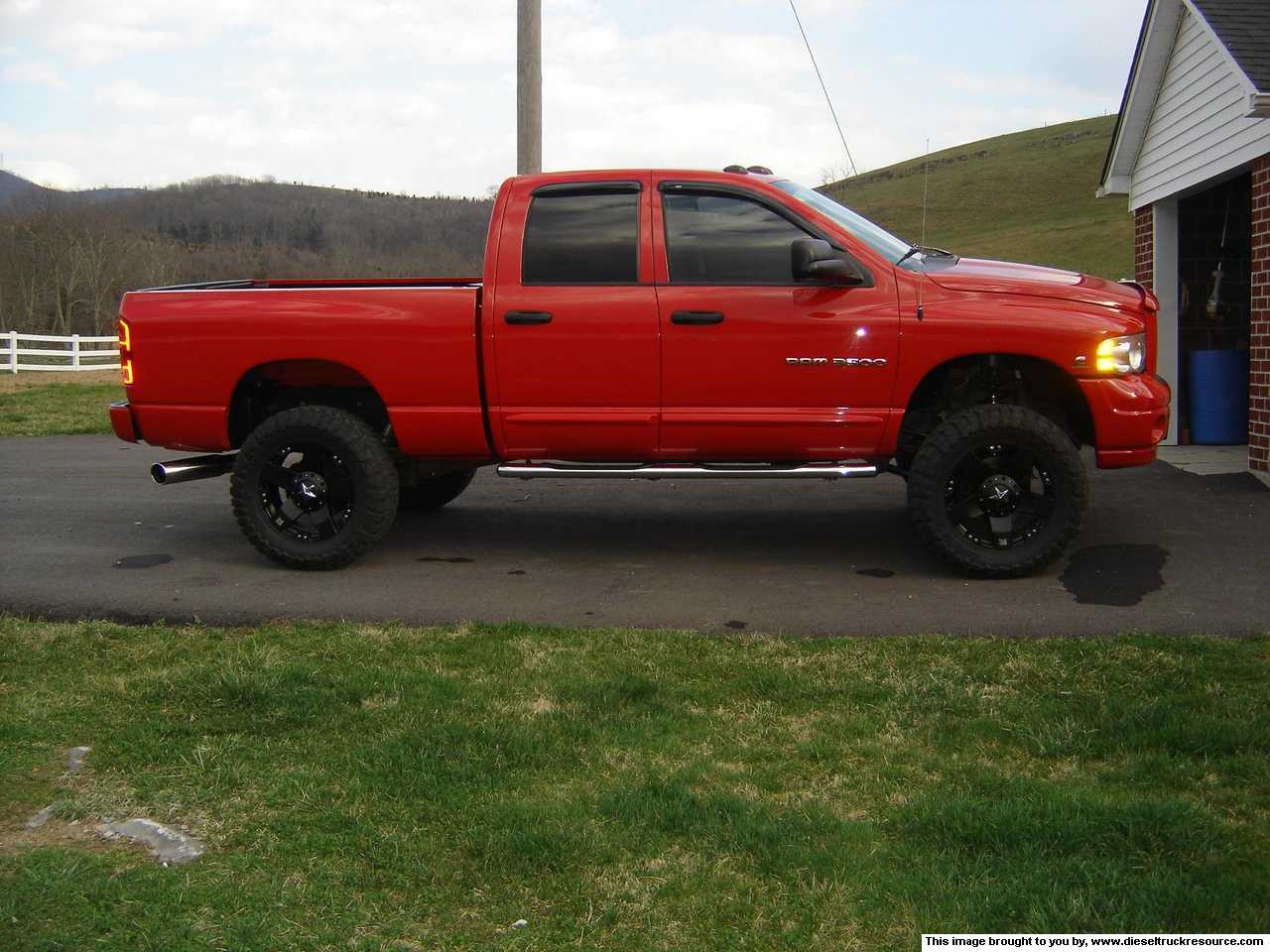

#72
Here is a quick picture I snapped yesterday. It really does the truck no justice, the sun was going down. I will try to get a better one today and put it up in a new thread.
