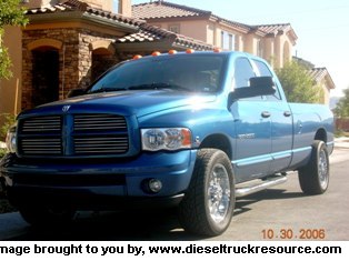

These are with the Daystar 1.5's.

Old Dec 14, 2006 | 01:51 PM
Smkn600CTD's Avatar
Posts: 328
From: Oxnard, CA
Its been in now probably about 3 months.
I did it myself, take about 1.5-2 hours, and that's me slacking
Its just a matter of taking out the shock, removing the caliper from the spindle. Get a jack under the control arm, loosen the upper ball joint nut, and using a ball joint seperator (NOT THE PICKLE FORK TYPE), pop it loose, lower the jack from under the control arm, and the spring and old spacer will come out. Then its just a matter of reversing the procedure. Make sure the spring sits into its groove in the bottom of the lower control arm when you reinstall it.
As for the alignment, its generally a good idea to get the truck aligned after loosing ball joints, and removing the springs/shocks.
But drive it about 10 miles or so, on the way to the alignment shop, to let the spring settle in with the new spacer.
4WheelParts has the spacers for about 75.00 bucks. Installed new shocks when I was in there, the stocks shocks are JUNK JUNK JUNK!!!!. You do not need longer shocks, just better quality
The suspension will be the same from 03-07 2wd 2500 or 3500.
The truck no longer bottoms out, and it now feels like it actually has front suspension, where are before it had virtually no spring travel.
