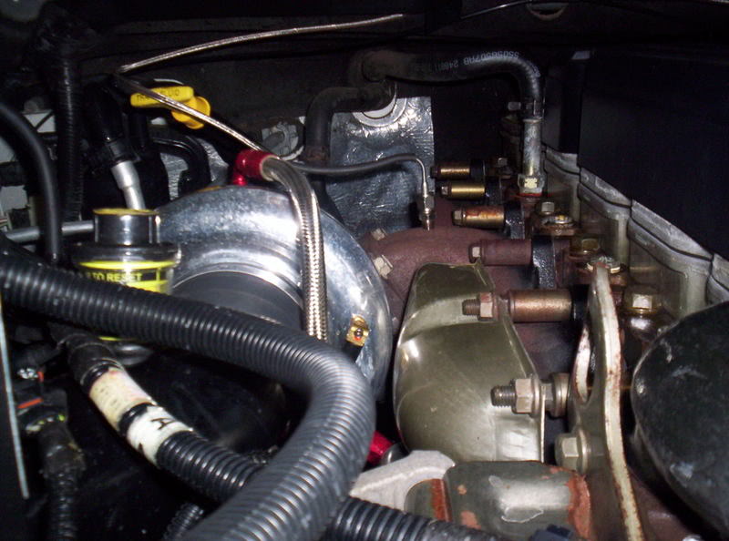

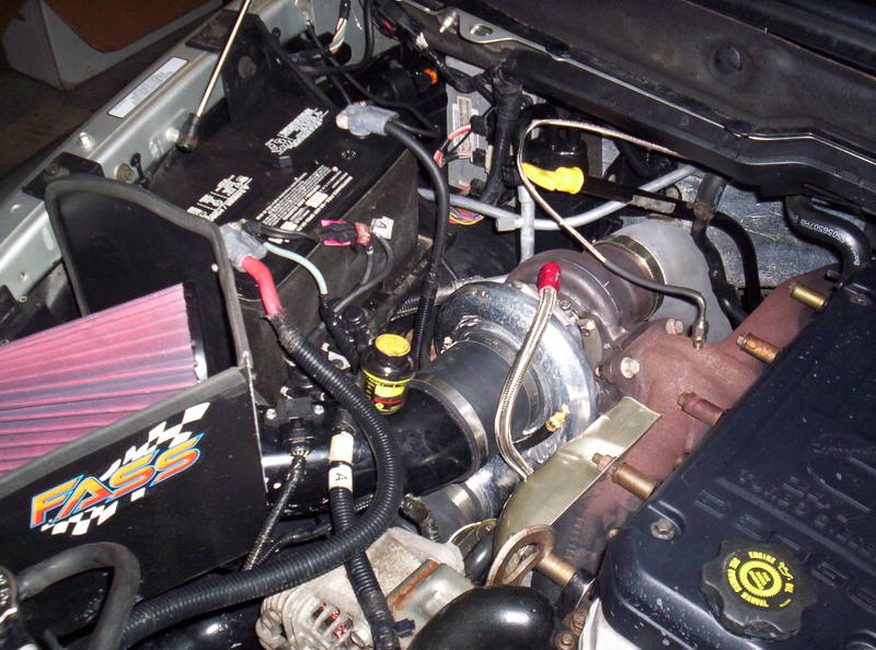

know im not the first but figured i'd share some pics
After gathering parts and dealing with a set of bad nozzels it's done:woohoo:

I used a stock 2nd gen manifold,II 3rd gen silver64,trimed 3rd gen cold pipe and modded 2nd gen hx40 down pipe. intake pipe is a 2nd gen AEM with a modded 3rd gen afe box.grid heater relays were remounted to the batt tray and had to mod a few odds and ends to make it all work.
Truck sounds good,got rid of the raspy WOT. Has the 3rd gen engine noise mixed with a 24v 2nd gen exhaust tone.

Originally Posted by Gwoody
What did you do on the oil drain tube from the turbo back to the pan?
2nd gen, you pop out the plug in the front drain and put it in the rear one.
you need to get the fitting from a 2nd gen also the 3rd is straight and the 2nd has a slight bend to it.
only real issue i had was waste gate hit the shock tower a little so i trimed the tower,not enough to weaken it.
