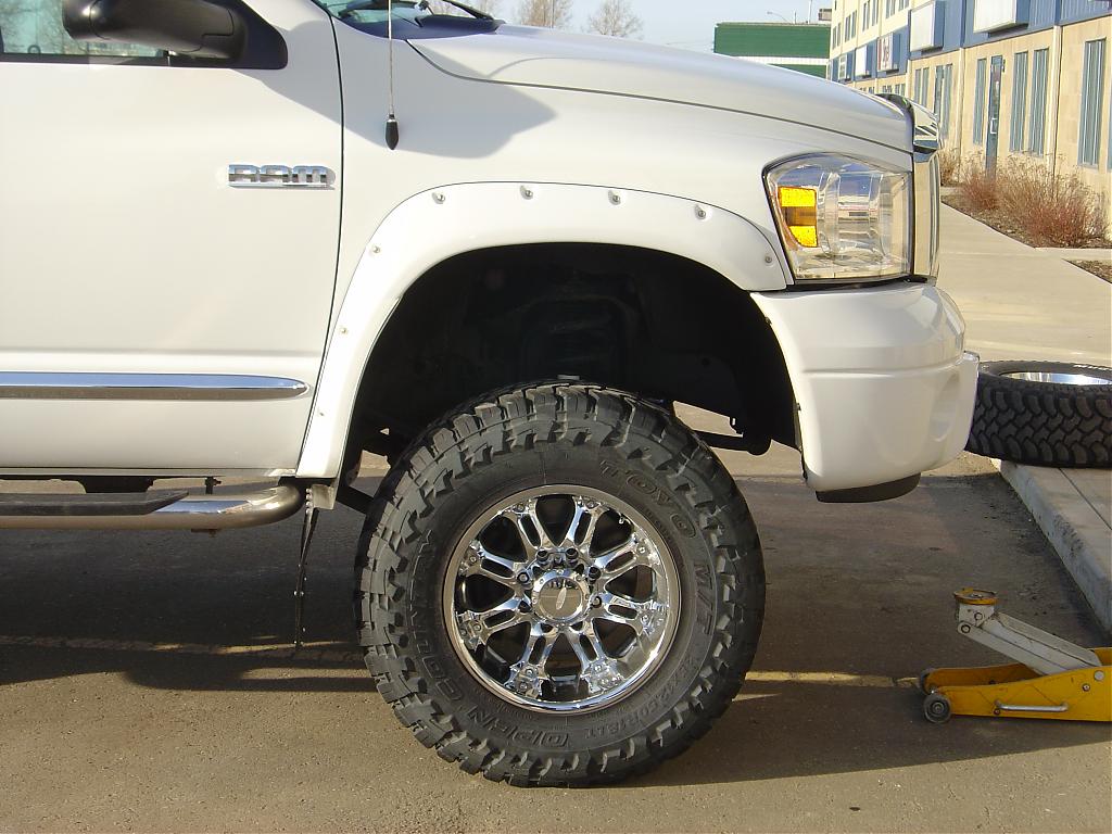

Question 20" Diamo's, 35" Tires And BDS 6" lift???
Do these look too small with my 6" lift???
Old Mar 21, 2008 | 11:08 PM
Lsufan78's Avatar
Joined: May 2004
Posts: 636
From: Ball, Louisiana
they do in my opinion...
Old Mar 21, 2008 | 11:26 PM
jiggerman78's Avatar
Posts: 239
From: Ft. Lauderdale-Tampa
i second that...
Old Mar 21, 2008 | 11:59 PM
J.T's Avatar
J.T
Posts: 134
From: Burnet, TX
I think soo too! jmo.
Old Mar 22, 2008 | 12:09 AM
RedRacer44's Avatar
Posts: 438
From: Mannford, Oklahoma
I concur with previous statements...but they still look good! Those wheels are big pimpin'
Old Mar 22, 2008 | 05:12 AM
prattman's Avatar
Posts: 300
Looks like you could use some adjustable control arms. The front wheels look pulled toward the back of the wheel well.
Old Mar 22, 2008 | 08:59 AM
snoyes's Avatar
Posts: 1,527
From: Delaware
I think they look too small. Too much wheel well showing. But, nice looking rims and tires.
Old Mar 22, 2008 | 10:51 AM
dodgediesel's Avatar
Posts: 3,190
From: Red Deer, Alberta
With using adjustable controll arms, wouldn't that mess up all the other adjustments?? Who makes them??
Old Mar 22, 2008 | 12:35 PM
tcr's Avatar
tcr
Joined: Sep 2003
Posts: 3,188
From: Austin, TX
Your truck looks great, get bigger tires when you need them.
Old Mar 22, 2008 | 01:51 PM
prattman's Avatar
Posts: 300
Off the top of my head Pure Performance http://www.pure-performance.biz and Rough Country suspension makes some.
http://www.roughcountry.com/dodge_4wd_2500_5x.html
Top Gun Customz carries some. http://www.topguncustomz.com
Adjustable arms will let you center the front axle in the wheel wells. You would probably have to adjust your drag link depending on how much you move the axle. I assuming you have the standard BDS 6" lift kit. BDS makes a nice product, but when you get over 5 inch lift with the control arms in the stock position the axle tends to get pulled back in the fender well. That's why you see 6 inch and above lifts with long arm options. Call BDS and see if you can purchase their lower long arm kit. It changes the lower control arm mounting points and you can accomplish the same thing. There is nothing wrong with your truck, I just think the axle looks better centered in the wheel wells. I have a Skyjacker 4.5" Double-Flex kit on my '98 12 valve and am upgrading to their 7 inch Long Arm kit in the spring. Nice truck and your tires do look a little small. Regards, Glen
Old Mar 22, 2008 | 02:30 PM
Posts: 3,190
Good enough. Thanks for all the help gentlemen, I appreciate it....
