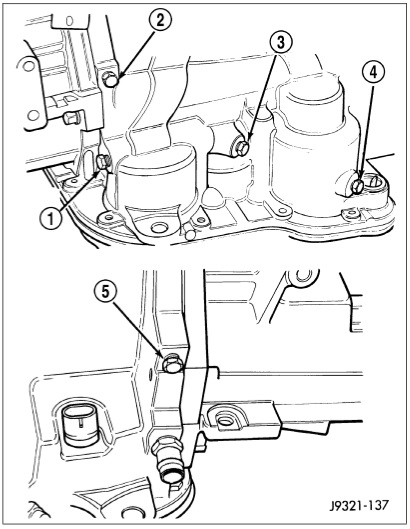

Which port is it?

Port 1 - rear servo pressure
Port 2 - governor pressure
Port 3 - accumulator (line) pressure
Port 4 - front band apply pressure
Port 5 - OD apply pressure
