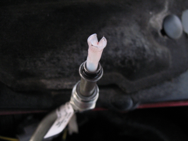

From another site I frequent, some Dodge technitions offered up some possible sollutions. Apparently the pressure lines are lined with a teflon tubing and it sometimes gets pushed into the booster cylinder.
I pulled it out today and found it to be flared and worn like it has been rubbing in there on something, just as these guys told me. Got all giddy thinking I had it fixed, but 10 minutes into my drive, it started to hiss again. This time not as loud and I could not get it to temporarily stop like I did before by tapping the brake pedal. Maybe a small piece of that teflon is stuck in the booster somewhere??? Dunno..
Here is what I found..

So being frugal, I just trimmed the tubing about 1/2" sticking out of the tubing and put it back in. Drove it for 2 days and now it starts to hiss again. I pulled the fitting apart to look see and its the same failure.. The tubing is creeping in the hose. I have a new hose ordered for it, ~$100 or I reassemble for them to do it under warranty.. I need the truck today, so I might just bite the bullet for the $100..
Here is todays tubing, hard to tell the difference..

About 2 weeks ago I replaced the high pressure hose from the pump to the fitting to the hydroboost. (Time constraints etc.) The teflon tubing is supposed to be embedded or locked into the rubber part of the hose. So from what I can tell, from my sudden steer and brake I popped it loose. It pushed out of the hose and through the steel fitting right into the hydroboost. That tubing was pushed about 7 inches through the steel tubing to get there. So trimming it was futile as its not supposed to be there to begin with. I should have known it was wrong when I pulled the fitting apart at the booster from the hose to the steel line and there was teflon tubing connecting them.... Not normal...
All said and done, they wouldn't warranty the hose unless they changed it on a service. So I paid $90 for the hose and did it myself since I had it apart already anyway. Problem solved. All I can say is that the 2 Dodge techs on the TDR diagnosed the problem in about 2 minutes over the message boards, local dealer....not so good.
