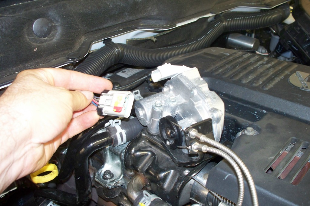

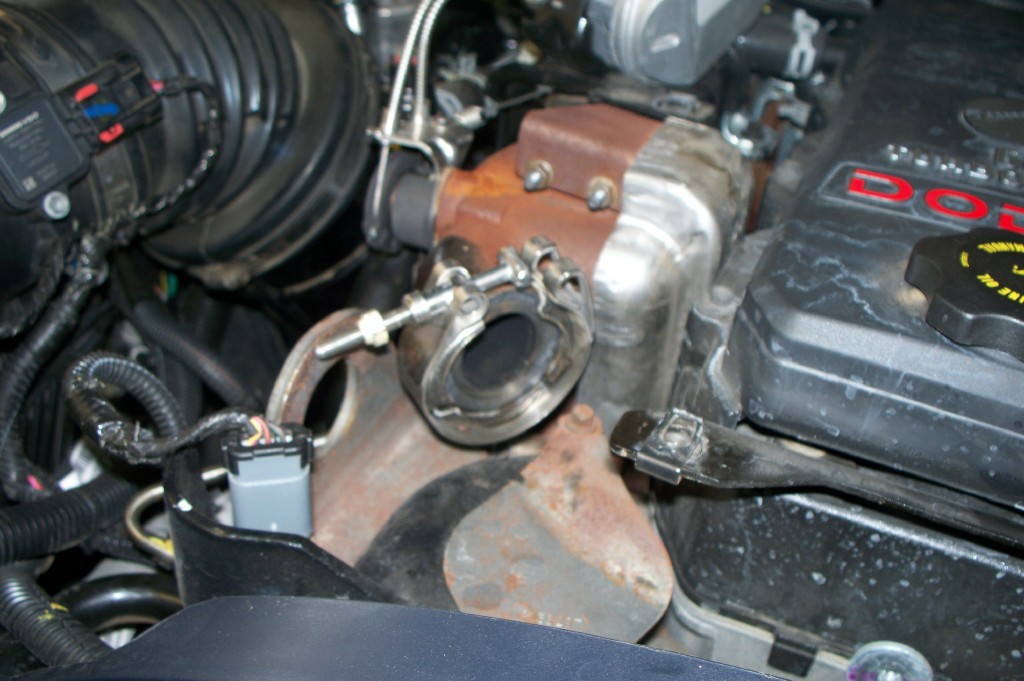

Hello everyone,
I need a little help. I tried to block off my xover tube today, but I could not figure out how to make the 1-1/8 freeze plugs work. I included some pictures of the unplugged egr and of the xover tube removed. Maybe someone can tell where I went wrong. I not sure if you're just hammer the plug in to the right side of the tube or what. Also the left side of the engine the tube opening is 1-1/4 inches, different than the right side.
Thanks
mike
Attached Thumbnails EGR xover tube pictures need a little help-egr.jpg   EGR xover tube pictures need a little help-left-side-no-tube.jpg   EGR xover tube pictures need a little help-rt-side-no-xover.jpg

First off, that plug is not the one you unplug. Many guys had problems after unplugging that one. You only unplug the one on the other side of the engine.
I'm interested to hear on the freezeplug thing too because I am planning on picking one up today and installing it myself. I would think that whichever way it fit easiest, either in the tube with the cup in or in the EGR housing with the cup in, would be OK as long as you can get it back together with the clamp. If you have to just lightly tap it in then I don't think that would hurt anything. If you really have to hit it hard then I think that may be a problem.....

Thanks Dodgezilla for the info. The 1-1/8 plug fits the right side of the tube but you can not get the tube back together with it in. At least that was my problem.

Alright, my NAPA had the 1 1/8" freezeplug in stock. I pulled the X-over tube off and installed the plug in the tube on the left side as you look at it. I put the dish in first and tapped it in with a hammer. Had there not been so much soot in the tube it may have just slid in.
Easy Breezy.....

OK, I'll give it another shot, there was a lot of soot in the tube.

It will work. It was a bit tight but it went in further and further each time I tapped on it. I went until it was flush. I just hope I never have to get it out.....
