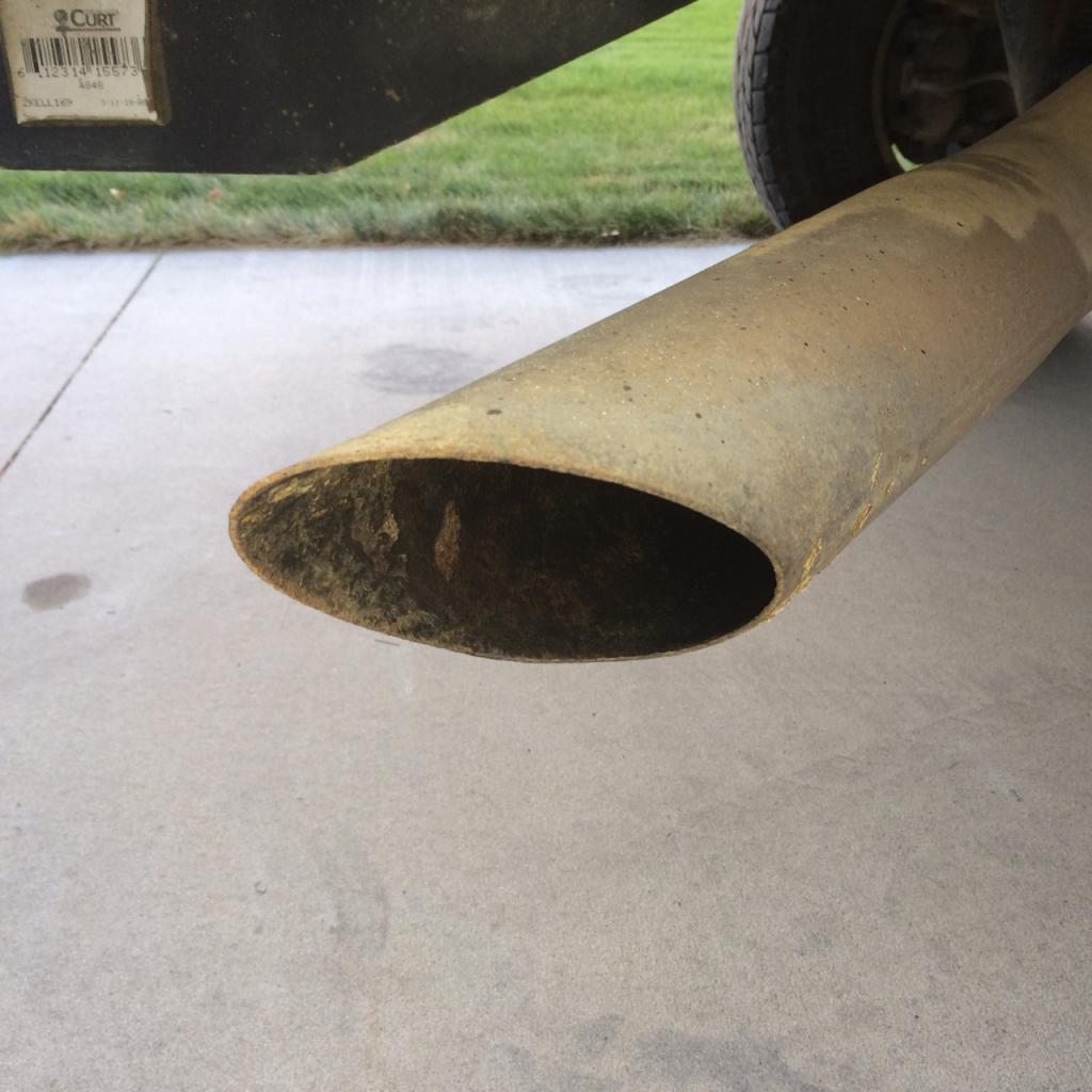

oh and a pic of my tail pipe!

Yep its melted/cracked. You probably had a P1451 code and who knows about the other. You could call the dealership and they can look at their record and tell you.

And there should be no soot in the tail pipe at all. Being cracked it probably won't fail the smog test especially if you do the obd test with no snap test.
