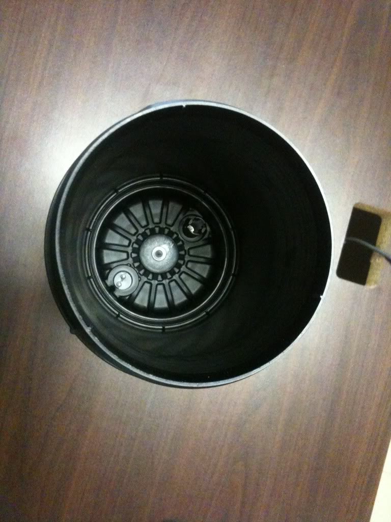

I have a 08 ram, 6.7L, I looked at the door tag just to confirm, pic 1, .

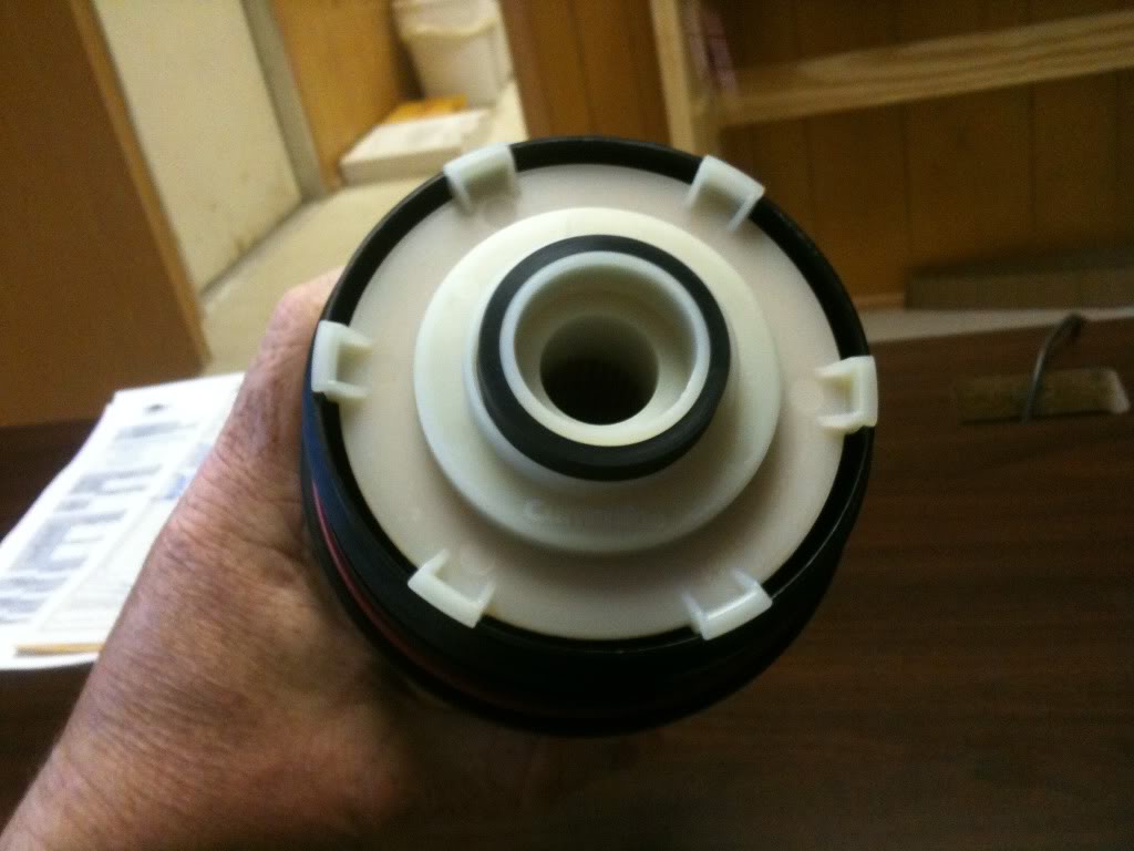

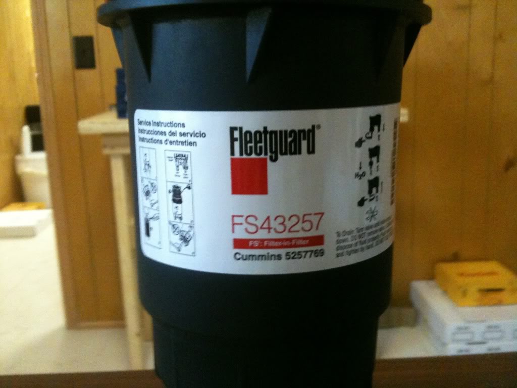

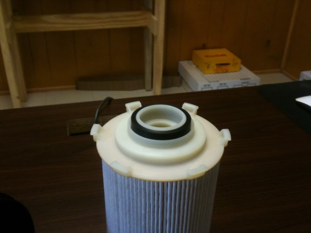

I went to NAPA to get a fuel filter, they somehow had a fleetguard back there, the only one left. I figured cool, and bought it. The box says 07-09 6.7L. Got home, removed the old filter, pic 2 is it. Pic 3 is the box. But the filter I pulled out is Pic 4. They were a little different, I figured it must work. But nope, the filter won't even fit in the housing. Pic 5 is the two filters, Pic 6 is the housing.
Anybody know why and what is going on? Is it possible the filter is for a chassis cab or other application, not a ram, and the housing is different?
Is there a different part number or name I need? The person at the counter may have not known what I really needed. Thanks for the help.....

Weird. Oh yeah, 5 attahment limit, it was the housing, was black, said Mopar. I have seen photos of fleet guard housings. Is it possible there are two different housings?
So your filter looked like the new white one? What did your housing look like?
EDIT: Your filter was white, was the housing? Maybe I just need to get a new housing. Did yours come with a WIF built in then?

This is the housing pic. In retrospect I should have gotten the whole housing, but I was interested that the label said through 2006. I think that applies to the business trademark though.

Did some reading, cummins went to the FS2 design in 08 some time, so sounds like some trucks, mine was an early 08, have the old style. The new white filter looks like it has a small inner filter on it, the old one is similar to the one from my 2000 ram. I have a feeling I need a new housing that fits the FS2 style filter.
Only concern then is, because this still has the old housing and I can't seem to find the old filter, DID THEY EVER CHANGE THE FILTER? I hope so.
What does the new housing look like, anyone got a part number?

my 08 cab chassis and it had the new system. the regular hd's got them in 09
